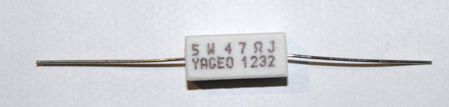

Here's a pic of the resistor that you need.
Attached Thumbnails warning light on after brake light replacement to cree led 1157-xj-brake-light-resistor.jpg
Dinger, where can I find this resistor. those I found over the web look very different from your picture,
and where do I install in resistor.

I think this resistor is the same - Radio Shack 5W4D7 - 5W 4.7 OHM 5% - Model: 5W4D7 | Catalog #: 55047951
5W4D7 - 5W 4.7 OHM 5% Resistor : Resistors | RadioShack.com
Try calling your local radioshack store.

The power socket that connects to the bulbs has two wires, positive and negative. The resistor is strapped across the two wires, so one end of the resistor is soldered to the positive wire and the other end of the resistor is soldered to the negative wire.
