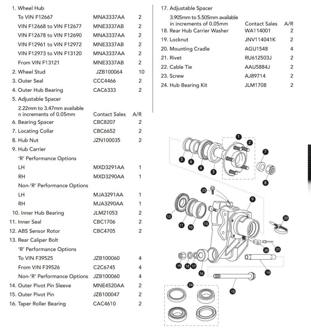

Okay we replaced the inner and outer bearings now the wheel doesn't wobble up n down anymore but right and left
The guy that worked on the car told me it's this part in the diagram number 16 i never seen any x308 with bad taper roller bearing am I the only one with this problem!

In this you have Robert Go the OP and process and mine starting in Post #7... https://www.jaguarforums.com/forum/x...ite-up-169352/
Reply 0
Mar 29, 2025 | 06:51 PM
Quote: In this you have Robert Go the OP and process and mine starting in Post #7... https://www.jaguarforums.com/forum/x...ite-up-169352/
I noticed I didn't have the pivot sleeve and the bearings were replaced already probably by previous owner I'm thinking whomever worked on the car probably forgot to install that pivot sleeve also if I install new hub bearings with that pivot sleeve I think all the bearings there will go bad . Lower back pain is not a joke I will collect more info and parts probably will work on this car next 2 weeks I have another car thankfully

Quote: I noticed I didn't have the pivot sleeve and the bearings were replaced already probably by previous owner I'm thinking whomever worked on the car probably forgot to install that pivot sleeve also if I install new hub bearings with that pivot sleeve I think all the bearings there will go bad . Lower back pain is not a joke I will collect more info and parts probably will work on this car next 2 weeks I have another car thankfully
I'd be concerned that they may had forgotten to put the shims back as well....and in proper sequence.

The rear hub lower pivot bearings are an *almost* standard part. My notes has them marked as LM11900EA. Note the suffix is critical here, these use a different type of seal which is designed to seal against the bore of the assembly, rather than the lip of the bearing (which has suffix LA). Of course if the Jag PN is in stock and reasonably priced then go with that, but just in case they become NLA, they are available elsewhere. One possible source: LM11900EA
The axle bushing (and particularly the spacers, part number 17 in Silverjag's diagram above) is also critical here for the correct bearing preload, otherwise the bearings will be destroyed quickly. Honestly if it's missing those parts (particularly the spacers, as those are adjusted to set preload properly), I'd just buy a used assembly that has all the correct parts with it and overhaul that, then swap it in place of yours.

Concerning the tapered bearings #16 in the parts diagram…… that lower bolt doesn’t even need to be loosened up much less removed.
