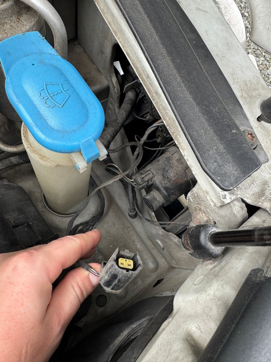

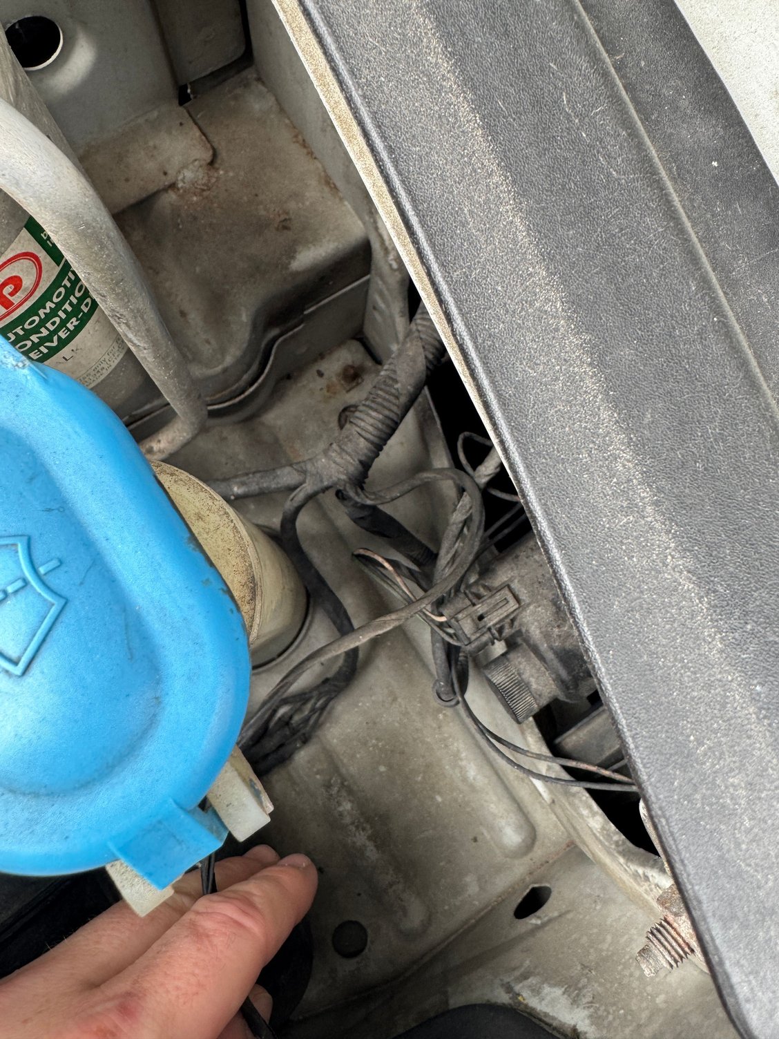

Hi everyone!
Does anyone know what's this connector for? It's in the front od the engine bay near light bulbs and washer fluid reservoir, just found it being there unplugged.

Forgot to add if needed: 1999 X308 XJR

If it's the bonnet switch, where should it be located?
Can't find anything to plug into

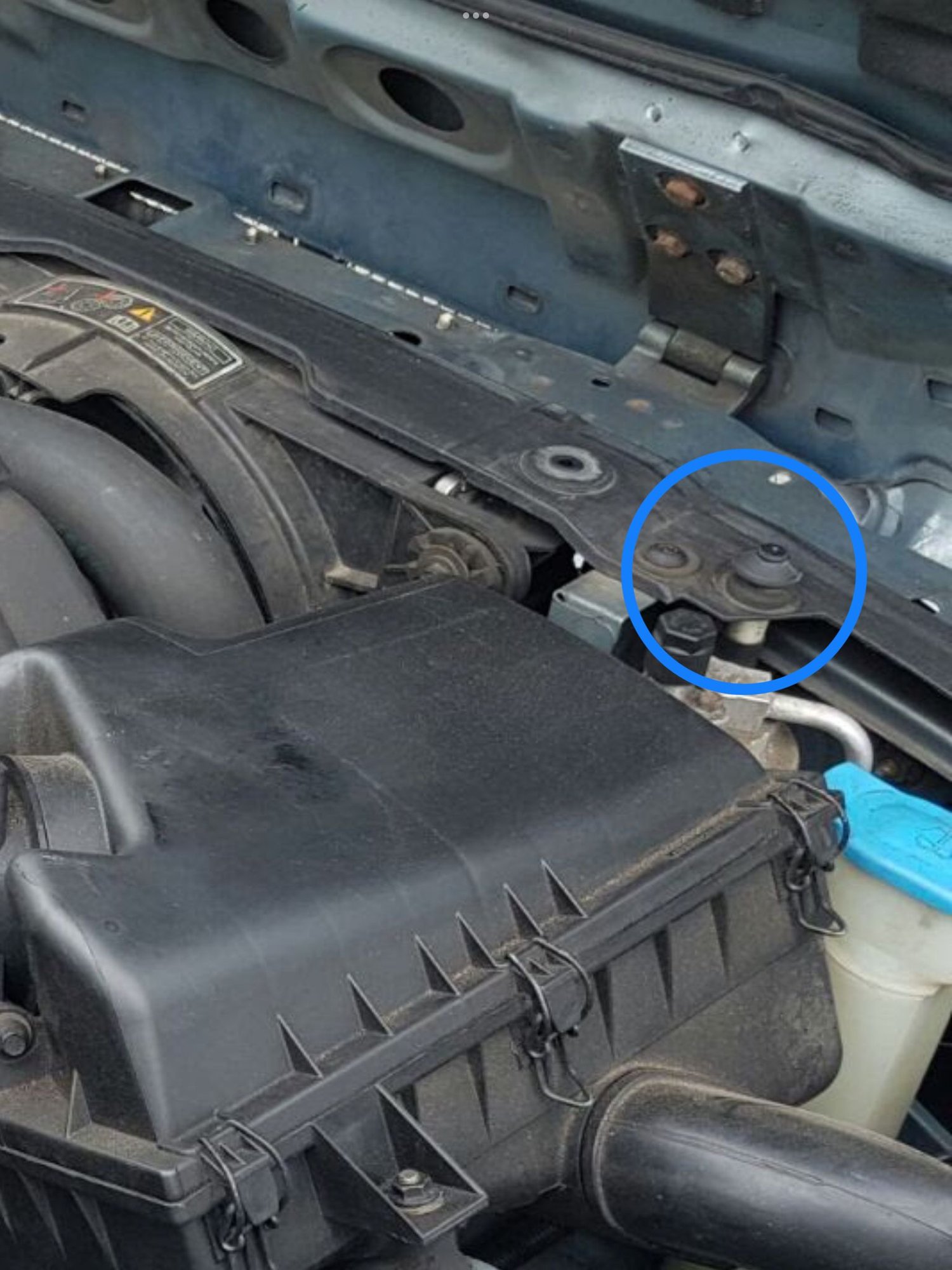

The bonnet switch would be mounted on the plastic cowling at the front of the engine bay, it looks like a door switch and is enclosed in rubber. Many have been removed because they stopped working.
Bonnet Switch circled in blue
Alright, learning something new every day!
This sensor is missing so I suppose the cable is for that. Won't be adding that anytime soon

North American XJ sedans don't have the switch.
