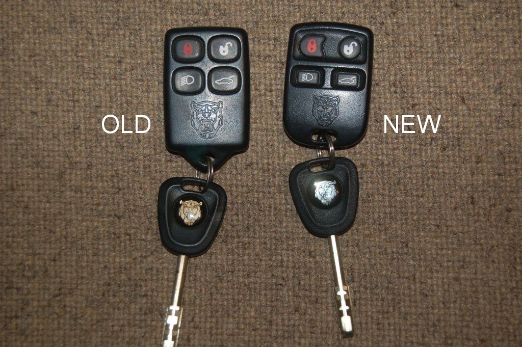

These are the 2 models of FOB's for the x308.
I am not sure which model you will need, guess the old one, but sure someone else will chime in to confirm that aspect.
The pic above is the 2 keys and keyfob transmitters to my 1999 XJ8L (left)
and my wife's 2001 XJ8 (right). I took that pic to show the difference between the 2.
The one on the left will work for X100/X308 cars UP TO (and including) MY2000.
The one on the right is required for 2001 MY onward.
The one with all the buttons the same shape is what you need for your 1999 XJ8.
The later ones have different lock/unlock buttons and SMALL boot lid and headlamp buttons. I heard that Ford keyfob transmitters will work for the LATER (2001 onward) X308/X100.

I'll add for reference I'm pretty sure I need the LJA2610AA model; 315 MHz for North American market.
There is also a similar looking model, LJA2610BA, which appears to be 433 MHz for the European market. Ironically, a picture of the back says "made in USA by TRW".
