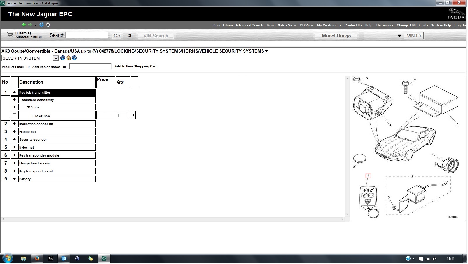

If he had looked it up for you on JEPC, this is what you'd have seen:
P/N LJA2610AA with a frequency of 315mhz.
Europe uses 433mhz which is no good for US spec vehicles.
If you source a used fob on ebay etc, you can programme it yourself without any tools. Keys must be programmed using dealer level Jaguar SDD.
