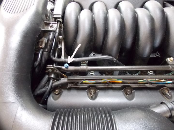

It's unlikely, but possible, that your fuel pump has failed. An easy test is to remove the passenger-side plastic engine cover, unscrew the blue Shrader valve cap, turn the ignition on, and either with your fingernail or the end of a pen or similar, depress the Shrader valve................gasoline should squirt two foot in the air. If no gasoline squirts out there is no pressure in the fuel rail, indicating a failed fuel pump. (have some clean rags ready to soak up the gasoline!)
It's easy to do, and costs nothing, so worth a try.
