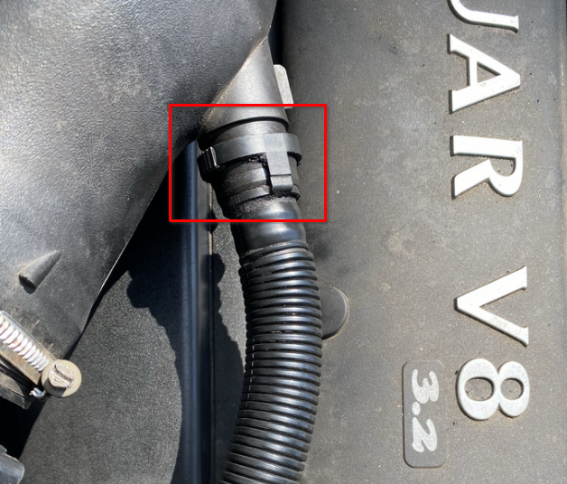

I have noticed that the plastic tube which is connecting the engine to the air intake on my 2001 Jaguar X308 3.2L is not sitting tightly any more. The plastic clamp at where the black spiraled plastic tube connects wo the air intake channel is broken on one side. Please find attached a picture of said black plastic tube.
Does anybody know if I can buy just the plastic clamp somewhere? Or does it always come as the "full black spiraled plastic tube"?
Thank you very much,
bf
The broken clamp in question is the black plastic thing at the top of the picture.

To make it more precise, I have marked the part which is broken on one side (opposite angle from where camera is) on the picture:

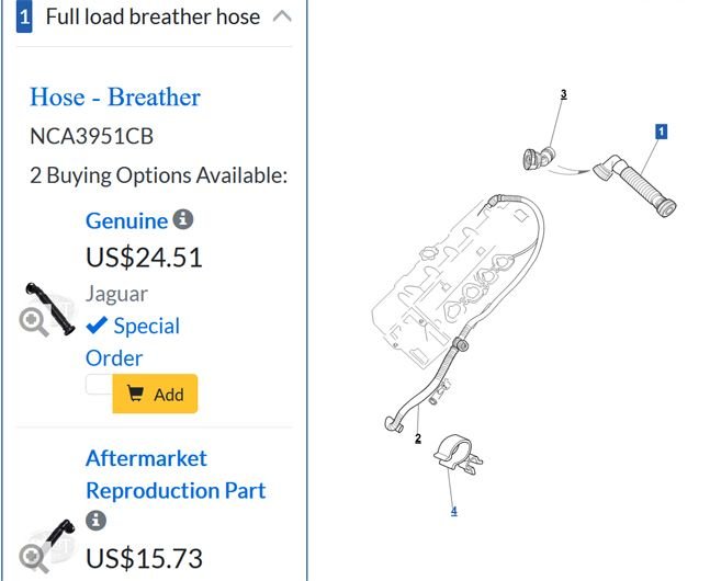

The complete hose is part # NCA3951CB and is available new from Jaguar suppliers, or as an aftermarket item from many sources like eBay for $20-$30 US (approx €20)

Thank you very much! Is there a specific tool you are using or do you know the part name by heart?
LOL...I wish I were that smart! There are several suppliers who have an online parts search, SNG Barrett has a good site where you can look up parts and their numbers.................
https://www.sngbarratt.com/English/#/us/home
