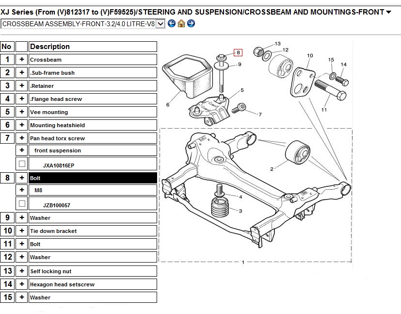

The two long bolts (item 8) are M8 and should be easily sourced. The Parts Catalogue doesn't give the size for the four pan head torx screws:
I've done several of these and have never had either the bolts or the screws break but have always given them a good soak with penetrating oil before attempting to move them. Maybe I've been lucky and MoscowLeaper has been unlucky with them.
On older models, hexagon bolts were used instead of pan head torx screws and these did tend to round off or shear.

Thanks for the reply guys have done a bit of shopping around and the M8s are easy to get hold of but the pan head torxs are discontinued (item 7 on the pic)
Does any one know of a replacement for these or know the thread depth so i can get a replacement before removal?

Happy days guys got a nice man at a garage to do the job for £250 including parts.
After he dropped the sub the engine mounts fell out as they where shot lol
he replaced those too, I'm happy to report no more knock or bangs from the front end and no more engine dip under breaking.
For new people looking to buy one of these cars jack up the front end and remove a wheel and check the vee mounts they are easy to see with the wheel removed and if the rubber has come away from the steel plate they need replacing they are located just behind the shocker and above the coil spring see pic https://www.jaguarforums.com/forum/a...il_welding-jpg
