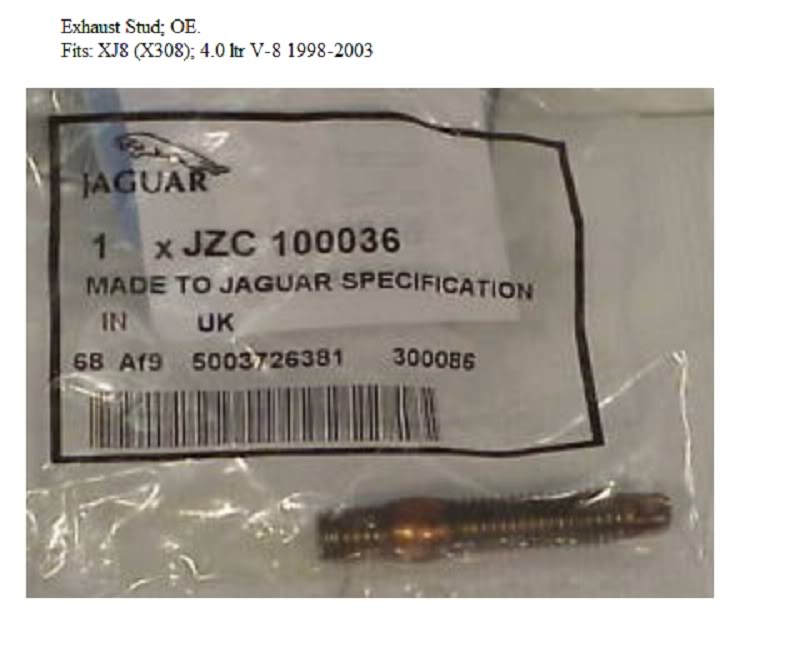

Did you find the part number for your manifold to cat bolts/studs?
I am not sure if the following is the exhaust stud part you need:
Call your local Jaguar dealership parts dept - Part# JZC100036 Retail s/b $5 each - discounted $3.81 each.
Jim Lombardi

jim i ordered them from ebay. and they ran me 2.99 a bolt. but thank you fo much. what i did was called jaguar in honolulo and they really helped me out. plus if you ever want to have a smile put on your face ask for mike in parts, i swear that he must have been baked when i talked to him and they always say aloha when you are done with the conversation. but i have extremely good news i put the engine is the car and after about 3 hours of crancking and it roared up. when ever i do a swap again i am going to always change the fuel before the crack the new engine.
