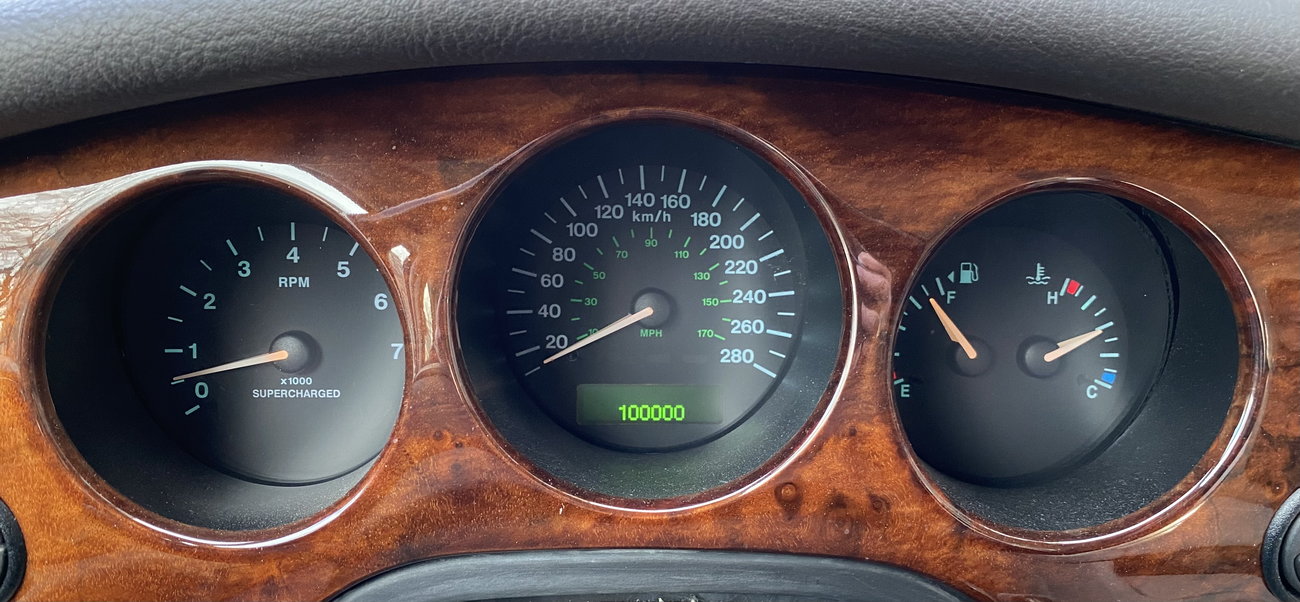

Does the car have a volt meter on the instrument cluster ?
Old Jan 9, 2023 | 05:56 PM
Ken Cantor's Avatar
Joined: Mar 2022
Posts: 4,518
Likes: 4,132
Tachometer, speedometer, gas gauge and temperature only...
Not that I would trust an instrument cluster volt meter, oil pressure gauge or the temperature gauge to be particularly accurate in any case (as an indicator of "not quite normal" perhaps but no more than that and the idiot lights probably do just as good a job of that).
PS apologies for the dust in the photo...
