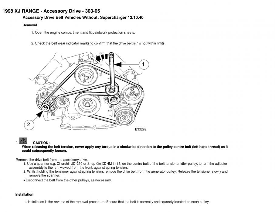

Also here is a link to Jpeg file covers the Accessory Drive Belt Removal & Installation:
https://www.jaguarforums.com/forum/a...503-water-pump-
Jim Lombardi
