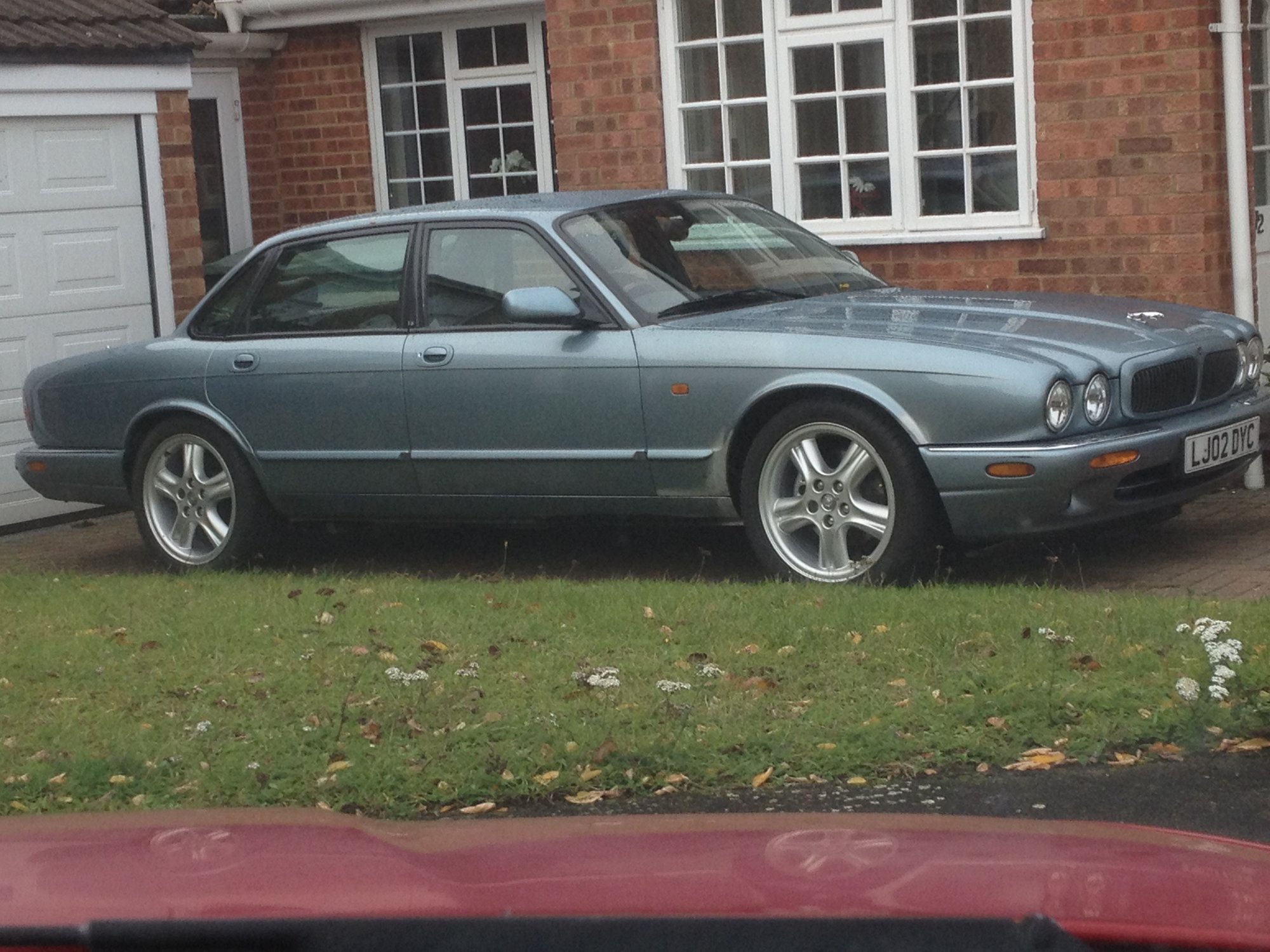

Hi everyone I've got xj8 3.2 sport 2002, at risk problem repeating a previous question? , can I use the xk8 rearsubfame in my xj8?, I'm pretty sure there the same?, I only need lower part the rest will be cleaned and repaired as necessary but lower part is beyond repair ( rotten as pear!) , so if I can use either one it gives more options availability wise,
First daylight for nearly a year!, going back her in now and tackle rearend
