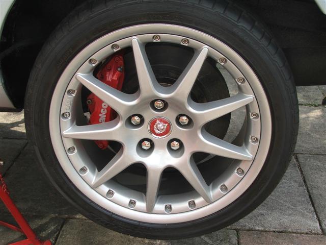

Looking good there Sean, I like your alloy centre caps-I may have to copy you!!

Thanks for the compliment Stu, you probably will, if I could drive it upstairs I would! I'll give you a go in it once on the road.
The red centre caps came with the 19" BBS Montreal wheels on the XJR 100. EuroJag do them used for £40, they're more than that each from the main agent!

Anyway-I may be tempted by a set of Reds being that it's my fave colour!! My current ones are grey which match my Platnium body nicely but are sadly starting to show their age a little
