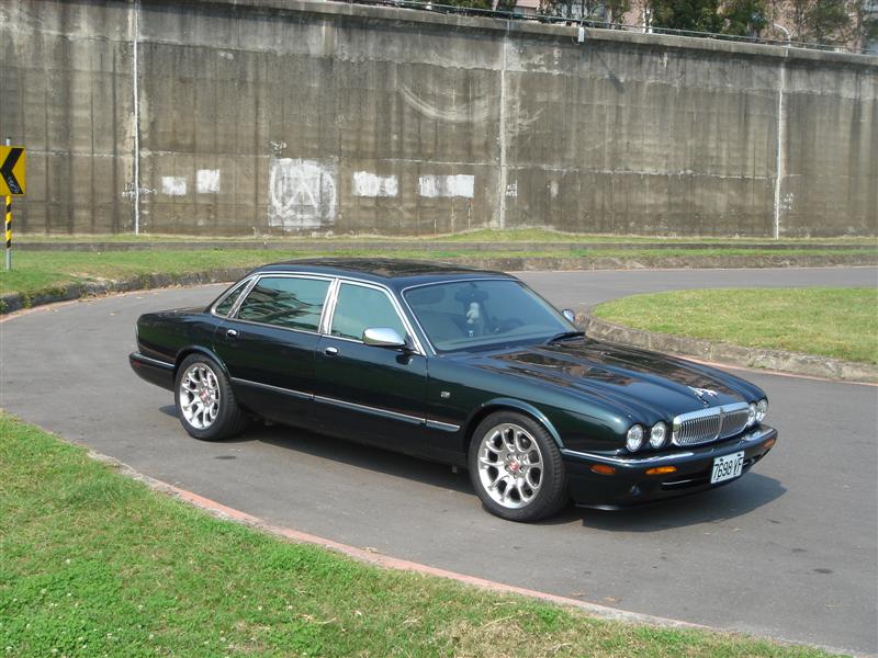

I actually got those numbers too, then measured my own car, only to find out the right passenger side rides 10mm lower then the driver side.
Got stuck in BMW forums on the same issues, then forgot all about it.
Will need to check my own ride height again against those numbers.
The Jamex springs are on various Japanese websites, incl. their biggest dealer on Yahoo.
Unfortunately, if you check, they are sold out.
They checked for us in a good Japanese way, but did not manage to locate a pair.
I read the Mina springs are not much lower on the front, I will wait to see how you get around with them first.
I got my wheels fitted yesterday, and actually I start to doubt if lowering is necessary.
The car looks pretty great, without the tires strangely sticking out under the fenders, so considering bad roads, I might leave it for a while.

That's about the same look as mine.
And that's with the european R springs at 360mm/360mm in
real life.
What size tires are you running?
The point that is most likely to conflict is between the rear of the
front tire well and the tire when you turn.

You got a good eye: I re-measures my ride height, and come to F: 360 and R: 350 with a 1/2 full tank.
As said, those are +5 on the left, and -5 on the right side.
I am running F: 145/45/18 on 8J, and R: 175/40/18 on 9J.
These run the same outer tire dimension as my original 225/60/16, although wider of course.
We tried to check each front tire on full suspended lock, without issues.
Above basically rules out the XJR and the Mina springs, as I do not expect any lower ride from them.
Perhaps I leave it like it is .

Well I'm running the same 245/45/18 on 8J all around as the ones
you have on the front.
So I already know that it is just about the biggest you can run
on the front. At full lock there is barely room for one finger in
there.
Either you have the non-US R springs already, or the springs have "settled"
due to age. Either way, it looks good now, so why change

I think your car looks great and doesnt need to be lowered at all. I also recently got new wheels and tires, but I went with 255/40-18s. I initially thought the next move would be to lower the car, but now that I installed the new shoes, she absolutely doesnt need to be lowered either IMO. Your car seems to be sitting even lower than mine, I wouldnt change a thing
