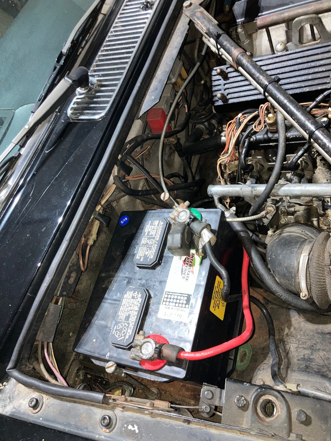

This is not my Series III but, I have in my possession an 87’ I6 (original owner 152k miles) and I cannot imagine where an auxiliary fan for the battery would be located at in a cramped V12 engine bay. Just out of curiosity, can you edit this picture as to the location of the auxiliary fan is at if it was a V12?

You are right, there was no battery cooling fan with the v12 engines, only with I6. I sold my Double Six some 15 years ago so I had to think again of what I actually had. After I bought the car, I had a problem that a new battery died after just about 3-4 months and I noticed that it was getting very hot. I saw the battery cooling box in some diagrams so I thought the PO had removed it from the Daimler for some reason and I thought of getting one and installing it. I ended up just building a heat shield with a layer of insulation around the battery and that solved the problem.
