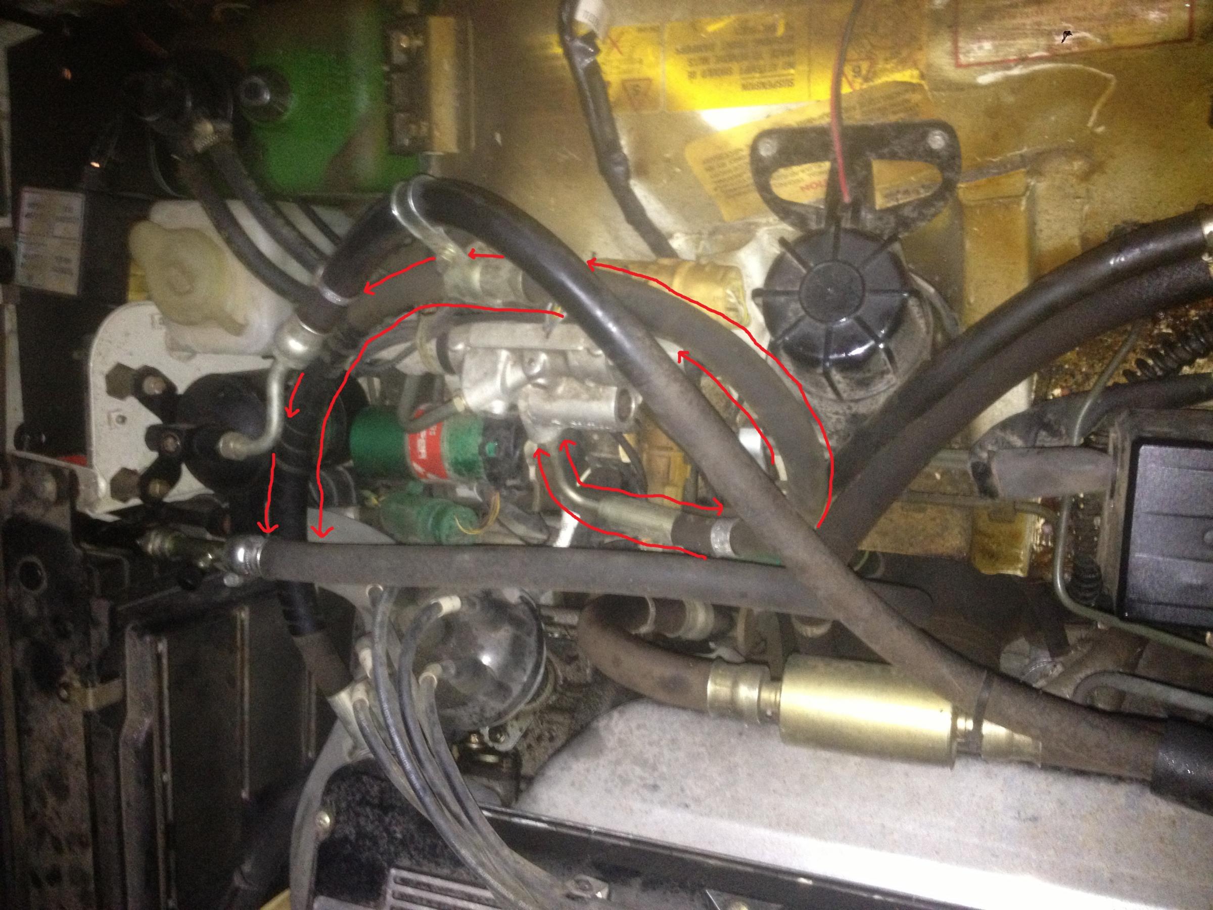

Something I noticed... The engine bay has some yellowish/blackish buildup on top of the wheel wells inside the bay, along with other various nooks and crannies. The car is white so this is easy to see. What could this be? Sign of some leak? or just dirt and buildup?

I might guess evaporated and molded coolant, but that would only make sense on the left wheel well under the coolant reservoir. Could the buildup be mold or tree pollen that has decomposed?

Ive attached an image of the Right Front of the engine bay. Forgive my poor edit, but the outlined hose is pulsating when the engine is running. Ive yet to receive my repair manual, and am ignorant to what this part is. Seems to be connected to mineral oil reservoir.

Well,I can't sleep,so might as well chime in,I pulled the SLS on Champ car,because the PO unplugged the system and just left it.
It rode too low,and mushy.Our Redd car is still equipped,still works,but will need done too.
The pulsing line is the high pressure from the hydraulic pump on the front of the engine to the valve that controls the fluid pressure to the rear shocks.
On your car this setup also provides power brake assist as well.You cannot just do away with this system.
Get some Castrol HSMO(hydraulic system mineral oil)this is the only product specified for these cars.
Refresh what is in the tank,Jack up the rear of the car,and inspect the rear shocks.
On the body of the shock assbly.there is a small phillips head screw for bleeding the shock body,each side,as well as a bleed screw located at the top of the union block where the lines branch to each shock.
It looks just like a brake bleed screw.
You will also see the Heim link to the electric switch that controls the pressure to the rear shocks.
With the car idling,pop the link and fool the car into thinking you have a full load,(carefully)and squeeze some fresh goo into the system.
Have someone top up the tank as you go,with some luck,the system may still be operational.
Good luck,keep us posted,Jim.
Back to bed.
