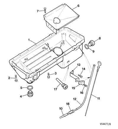

Regarding the oil drain plug, it is on the rear end of the oil pan/sump, part 8 in the diagram below. Don't remove the oil relief valve plug, part 4 in the diagram, which is near the front end of the sump:
