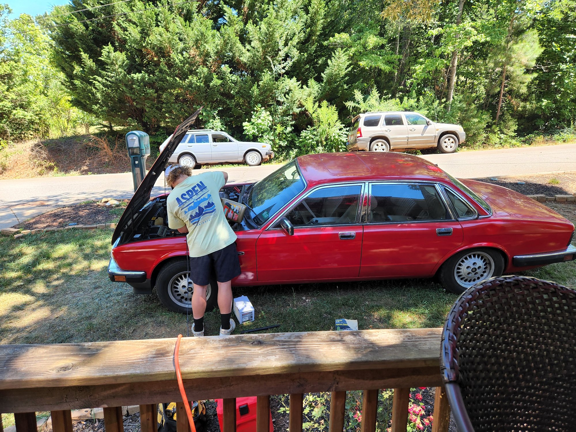

Newbi to the jaguar world. My 16 year old son just recently purchased a 1990 jaguar XJ6 sovereign in great condition. Only has 80000 miles. He drove home from school one day, parked in the driveway and noticed he was leaking coolant. He added more coolant to it and drove to work and parked it. It set for 4 hours And when he went to crank it backup It would not run. Noticed a bunch of coolant underneath the car more than when he 1st noticed the issue. Had to get car towed home. When I looked under the hood I noticed that the O-ring gasket on the thermostat looked like it had been Squished from possibly overtightening of the thermostat housing. Some water had came from the housing as, I proceeded to look under the motor I noticed more water was coming from underneath. I checked the oil in the motor and it was not milky. My 1st thought would be to change the thermostat and the O-ring And then the water pump. My question after all of this, is in my experience I have never known a car to not start and run with a bad water pump is that something common for jaguars.

Thank you sleek for replying. Yes further looking into vehicle is in process. The car never ran hot, but I have discovered and low coolant level sensor that is in the reservoir that was corroded. You can see in the pictures. My new question is if this sensor went bad, does it send a signal to the computer that water is too low and it would keep something from allowing the car to run. The car will crank just not run, and there is no water in the oil. It just seems weird to me that it was running fine when he parked the car, in the 3 hours that it sat, all the coolant poured out from wherever, whether it was the thermostat housing or the water pump gasket or gasket or hose, these are still to be determined, That it would all of a sudden not run. I know this particular model has a buttload of sensors and fuses etc. That's kind of why I was wondering if this sensor had something to do with possible fuel sensors or firing system that when this sensor is activated it has the computer activate other sensors to keep the car from doing more damage down the road and running until water level is normal. Also if this scenario is a possibility, will the computer need to be reset or cleared when said sensor has been replaced.
This sensor goes in the reservoir in the background on the left side in that black hole. That resistor or diode is broke. I had it soldered with aluminum solder back together. I have yet to put it back in the car to see if it is functioning properly.

Thank you all for the advice. After further investigation we found that the thermostat housing had a huge hole in the side, iwould assume from someone either over tightening or whatever. So we are replacing housing, gasket and thermostat. Also discovered fuel pump had went out so we have also replaced with new fuel pump, and filter. Hopefully we will be back up and running within a couple days. Thank you all

She is back on the road. New fuel pump, sender, filter, and clean gas tank, water pump, belts, thermostat, housing, gasket, one or 2 swear words and several hours
of intense labor she is running like a charm.
