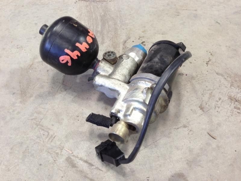

is this what the item you are talking about looks like? I did the test and it failed so I am looking to replace the part. Before I go spend big money I need to make sure we are talking about the same part

Hi jagking93,
The large black metal sphere is the hydraulic brake accumulator. The black cylinder with the electrical harness is the pump motor. The silver cylinder with blue electrical connector is the combination low-pressure/warning-lamp switch.
If you shop around and do some homework, you may be able to find a more affordable price on the accumulator. According to reports in the Jag-Lovers XJ40 forum, ACDelco part number 25528382 as fitted to several GM models from 1986-1990 is identical to the Jaguar accumulator. At the time of those reports, prices on the ACDelco part were as low as $115.00, but I'm sure that if still available the price has probably increased.
Here's a link to the GM vehicles that used the ACDelco 25528382 accumulator:
http://parts-catalog.acdelco.com/cat...&parttype=4106
This link indicates that the Chrysler TC "by Maserati" also used this accumulator, but that info is not likely to help us much, given the rarity of those cars:
http://forums.aaca.org/f144/tc-brake...rt-372234.html
I suspect that the accumulator used on some BMW models from that period may also be the same, but I have never confirmed it. Has anyone else?
You might also check eBay for a good salvaged accumulator which might get you down the road for awhile if the price is right, but spending too much on a used accumulator might prove to be a false economy if it fails sooner rather than later, especially since eBay sellers seem to want a lot of money even for used accumulators. One benefit of purchasing a salvaged assembly like the one in the photo you clipped from eBay is that you get an extra motor and switch, both of which are no longer available new and can be very expensive even when used.
