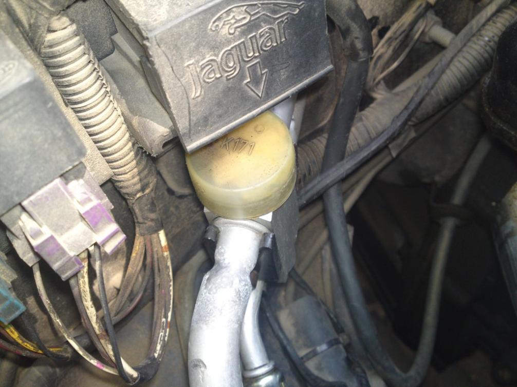

Finally, evaporator replaced by a new one and hopefully it will be ok . I no longer hear a " breathe in / out " sound which was an oddish one lol
Here are a few pics of the new evaporator which was installed
Old faulty eva on the table as you can see . I presumed something bigger lol
Attached Thumbnails Evaporator - FIXED-16052010083.jpg   Evaporator - FIXED-16052010084.jpg   Evaporator - FIXED-16052010088.jpg
Cadillac.
That looks more like an expansion valve.
The evaporator looks like a heater core and is found inside the passenger compartment.They tend to get plugged up over time just like heater cores.
Most times we would replace both since they are usually side by side and a crappy thing to change and the heater core has to come out to get at the evaporator. This might not be the case with all Jags????

That's true MyBlackCat , you're right and recently I was told that another XJ40's evaporator replaced due to similar problems .
My passenger compartment was removed to access the evaporator .
