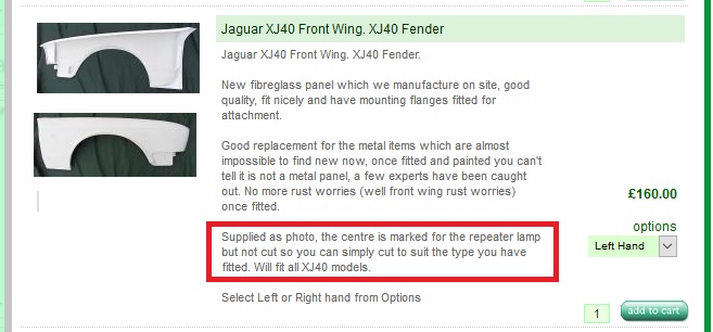

I've searched UK listings for XJ40 front wings and they mostly refer to "early" as up to 1991. Unfortunately none list the specific difference(s) between "early" and the later pattern.
However, there is a supplier of fibreglass replacements who claims "the centre is marked for the repeater lamp but not cut so you can simply cut to suit the type you have fitted. Will fit all XJ40 models."
From this it sounds very likely the only difference between the part number options listed in JEPC is the side repeater cutout.
