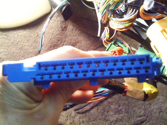

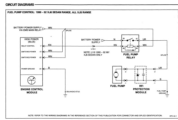

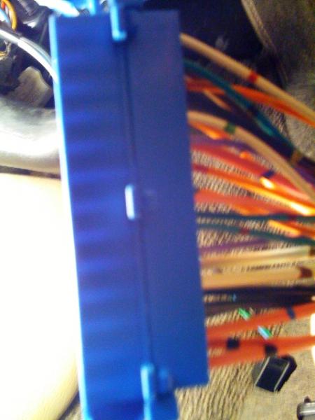

I am a little confused on how to count the pins on the blue ECM connector.I am not sure which way to start counting. I need 7, and the color code of the wire is KN, that also has me confused.
I am trying to diagnose as pic one describes with this circuit issue. Pic 2 and 3 is the connector, and the colored wires. Any help would be great.

I had a friend come over, because trying to work on that fuel pump issue by myself was difficult. He was able to get under there while I turned the key, the fule pump was seized. Car is running again. I did fix a few loose connections on that blue connector to the ECU, the 22 code is gone. Thank you gentlemen. I'm on the road again.
