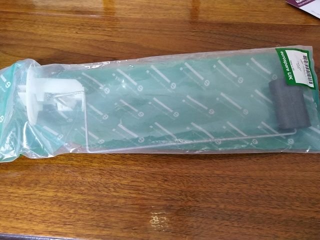

After an inspiring post from Don B about the fuel sending unit being a relatively straightforward job on these XJ40s, I figured I'd take a stab at it.
Sourcing the part itself proved to be a bit tricky. None of the local chain auto parts stores had one listed, nor did RockAuto. A bit of "creative googling" lead me to the following part on
Amazon Amazon
: the "Eurospare DBC012042" (Mods: if the amazon link is frowned upon here, please remove it.)
For $67, I took a chance and went with it. Although Don commented that below 1/4 tank of fuel was the sweet spot for replacing this thing without making a mess, the actual fuel level was a bit difficult to determine. I filled up, drove a couple hundred miles, and hoped for the best.
Here's the part:

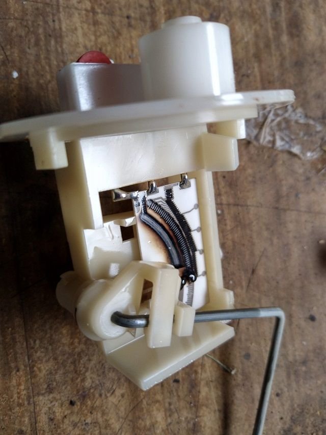

For anyone interested on a "postmortem" on the original sending unit, here's what the contacts looked like after (potentially) 24 years of use. I wish I'd taken a similar photo of the new unit, but needless to say, this one is pretty badly "burned up."

Just throwing this out there- did you compare the units side by side for bends or lack of, in the rod? If not, maybe you can do a study and make an "adjustment" after you decide where the float should be registering. I know..."Its not MY fuel tank, no more work for me to say that!" But I got my "fill" when my tank collapsed.

Your indicated level may be accurate - the tank never fills up completely, otherwise raw fuel could make its way into the charcoal canister and foul it. It is possible to snag the sender float rod on the wiring harness for the fuel pump or its plastic canister, but if the level indicated by your gauge declines as you drive the next few days, it's probably fine.
