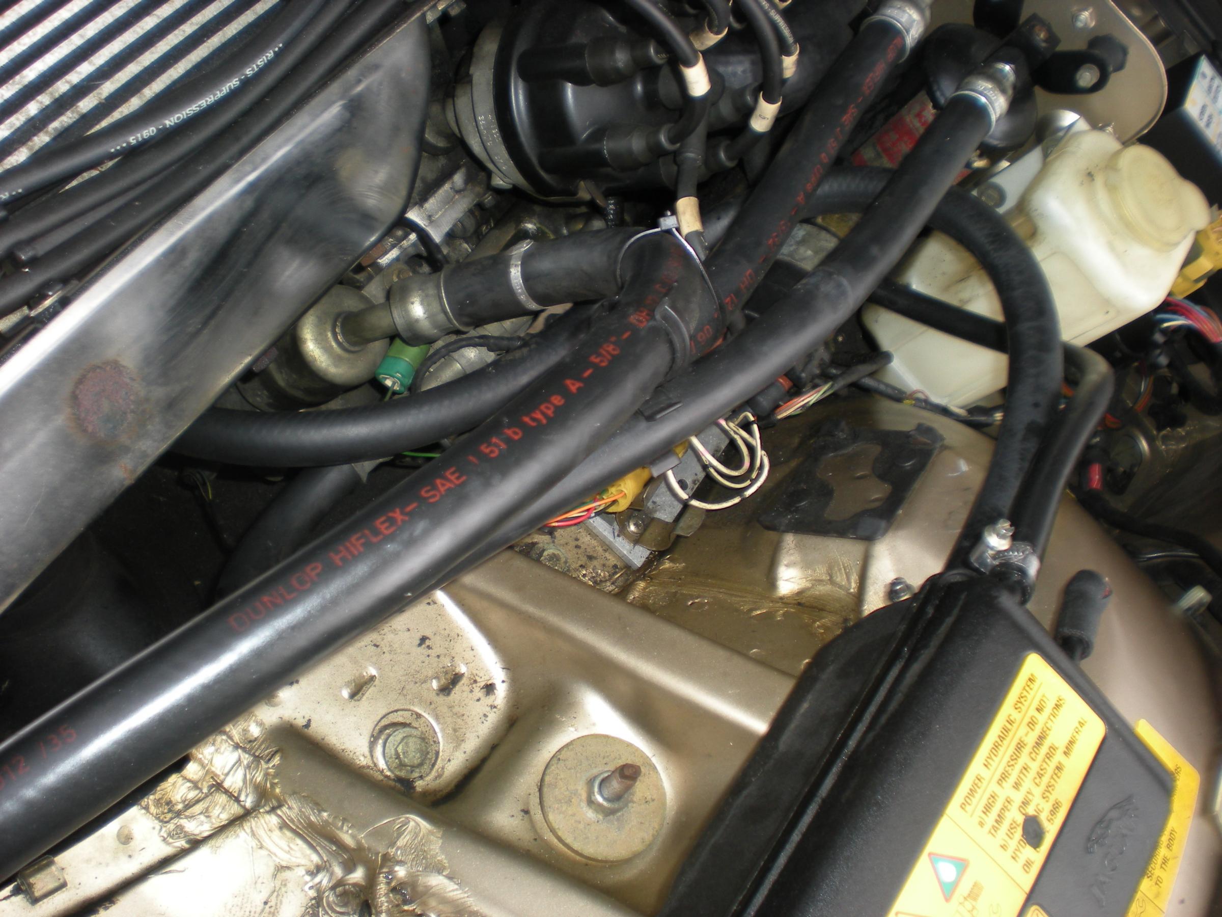

Fairly straightforward job,suck out the tank,pull it out of the way,and you are better off to cut the hoses rather than risking busting off the tank fittings!
Two screws hold the coil down,just get it out of the way of the "why?" hose
Snip the offending hoses off,but mind there is a screw holding the hose st the front by the pump.
Also mind your paint!This stuff can be hard on paint.

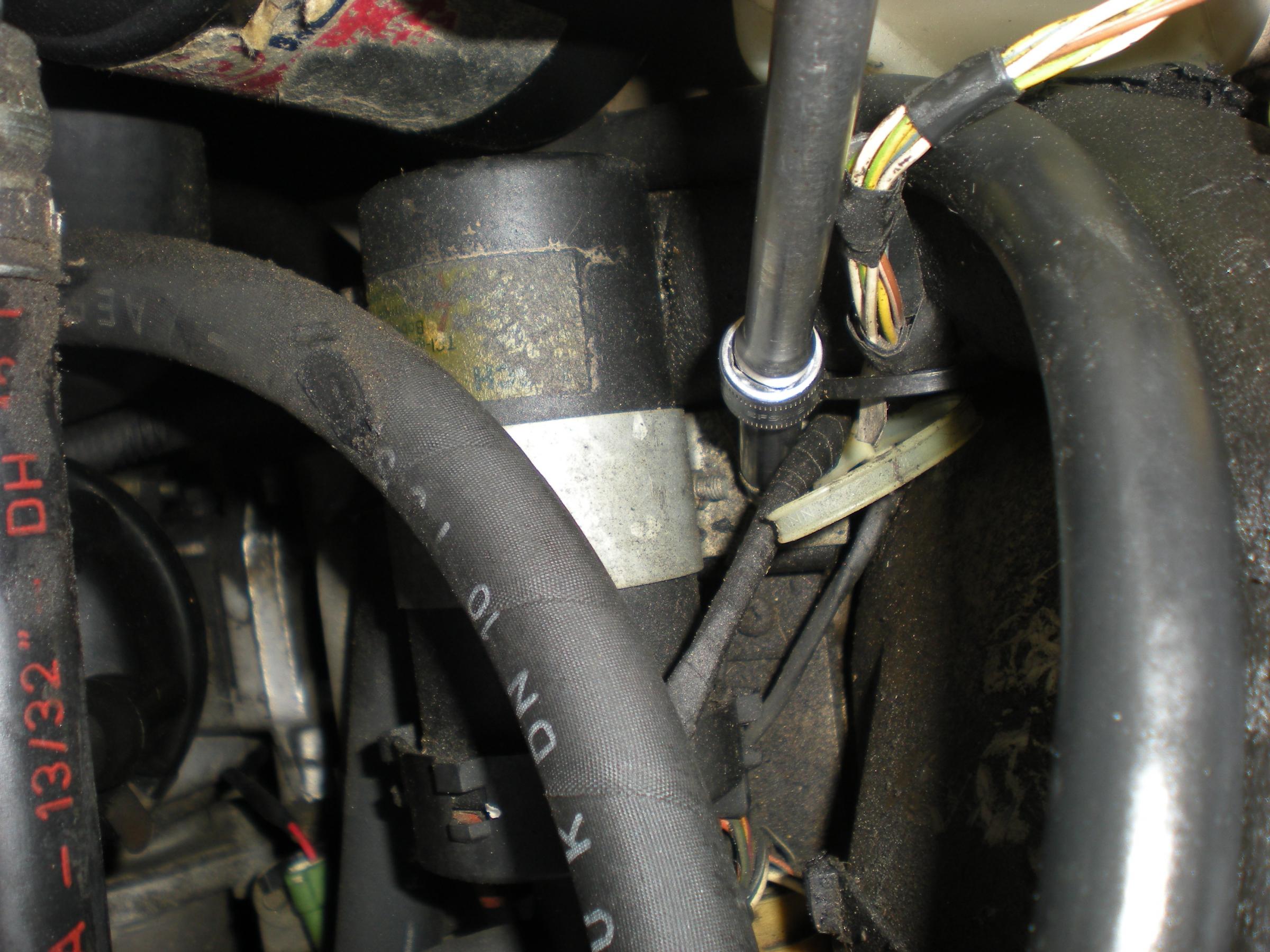

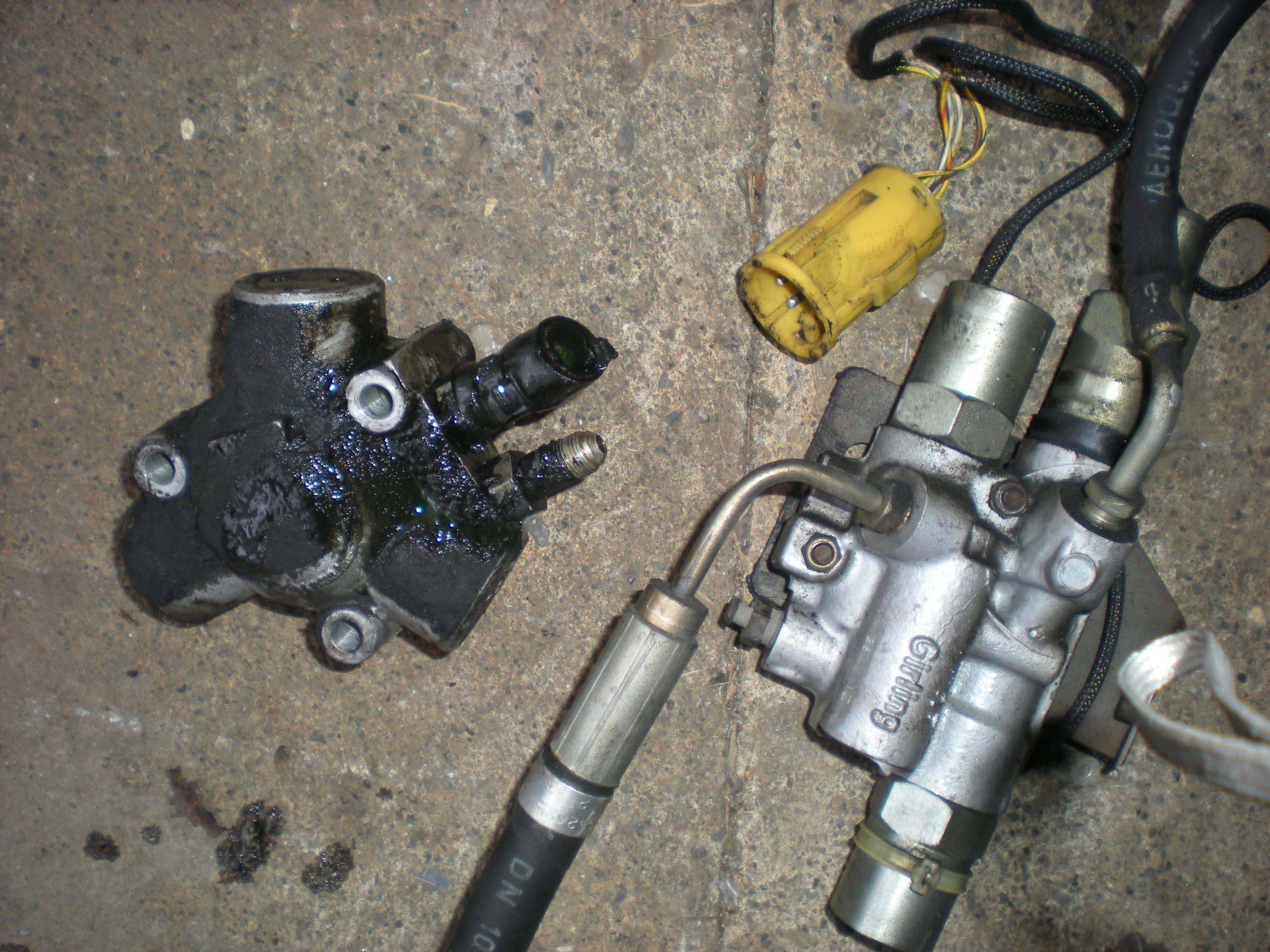

Three bolts hold the pump on,10mm wrench,sneak by the fan,it will come out.Under the car,undo the return line to drain the goo from the radiator cooling tank,wait to drain(drink beer)
I just snipped the rubber mounts for the valve,will remove the base later.

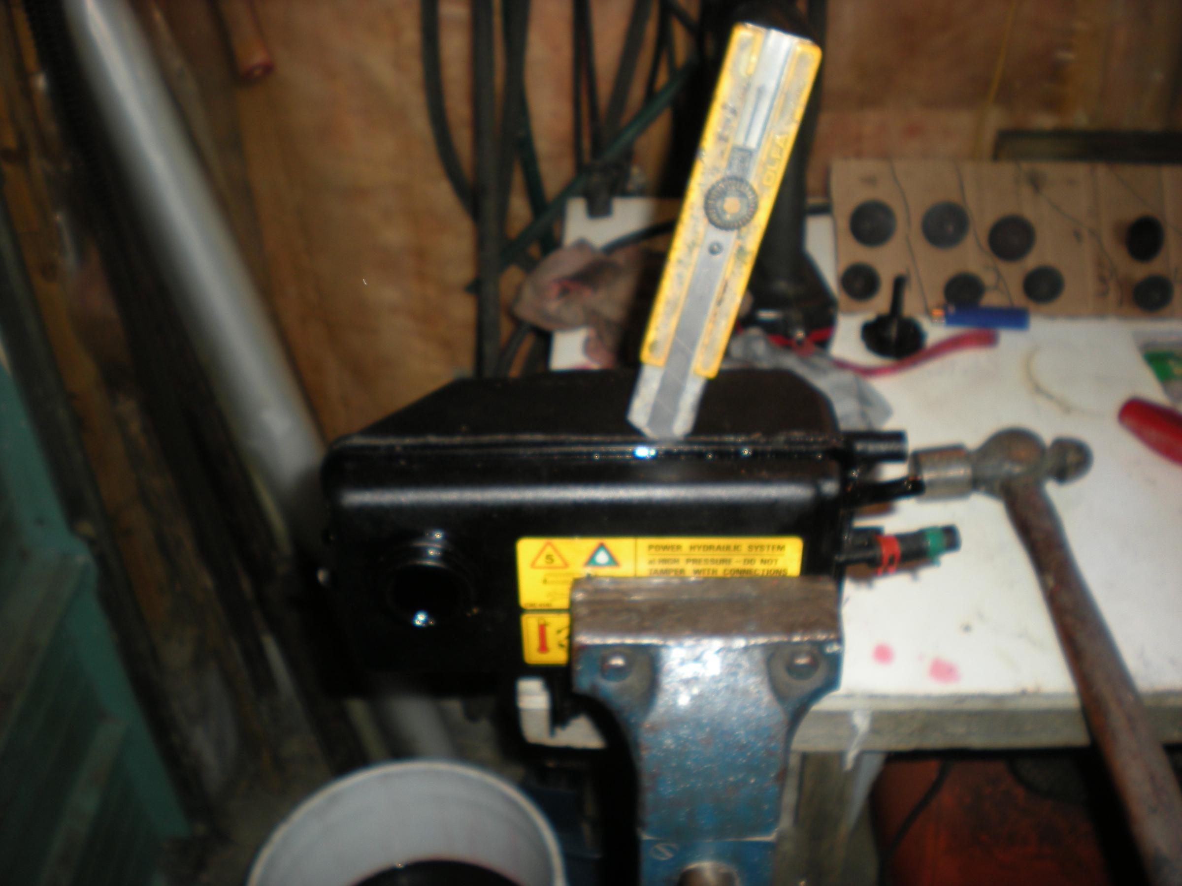

Pulled the tank out today,and the seam at one corner of the tank let go..

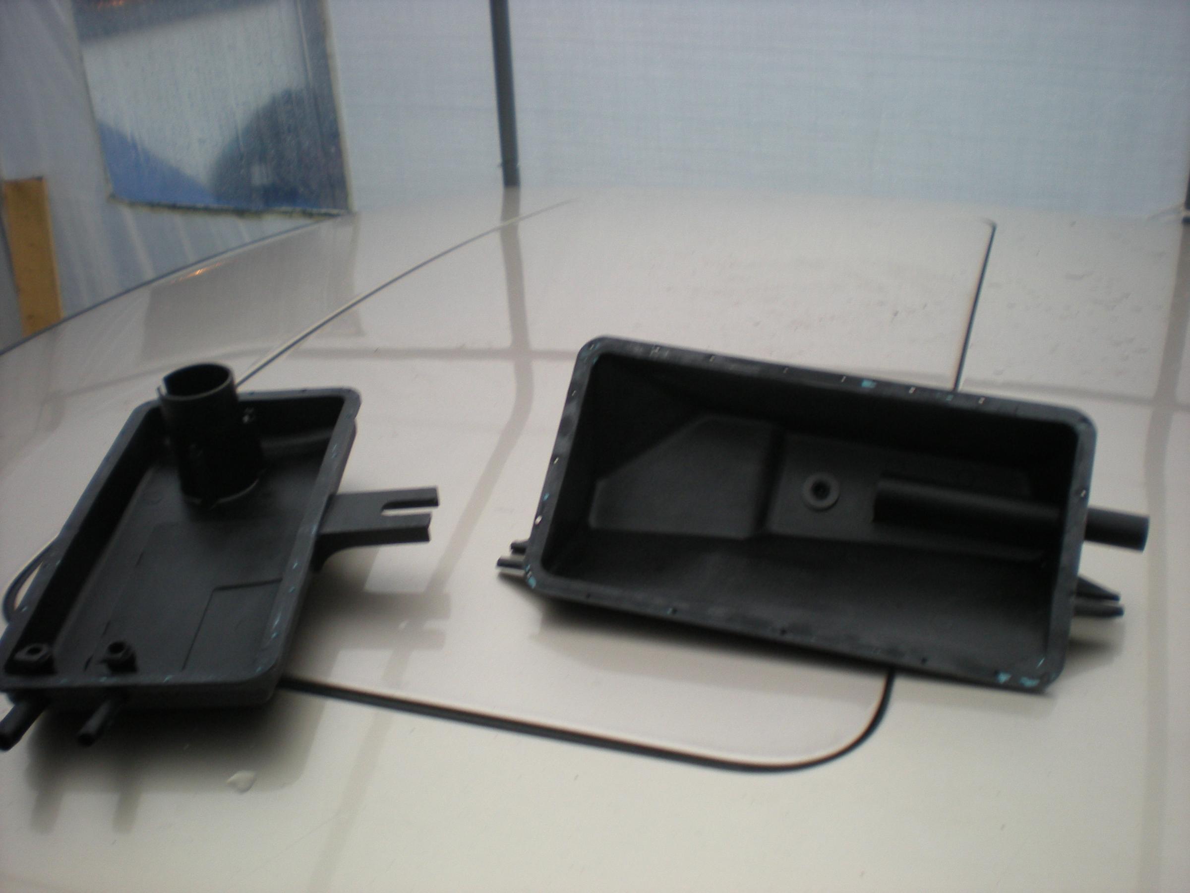

Went to work and carved open the tank,use a very sharp knife and work at it.Took a good hour or so of prying and carving,but I got it open without wrecking the thing!
Got my dremel tool out,machined everything flat(the top half has a warp)and proceeded to pin the tank together with some #6 brass wood screws.
This plastic holds a screw quite well,but you have to pre-drill first.
I took out some of the baffles in the upper half while I was in there,and reassembled with polypropylene epoxy.
I hope this will hold,gonna try it out tonite!

Removed the tank again,did not see any cracks or other leak points,so I removed the screws and Yikes!
The top half came away without a fuss at all!Poly-epoxy must be the wrong product.
Cleaned everything up,and tried good old PL premium adhesive instead.
I really hope this works.Oh well,it's raining buckets,a good day to sit by the fire and ponder,drink beer,and let the glue set up.
Hope this works.
