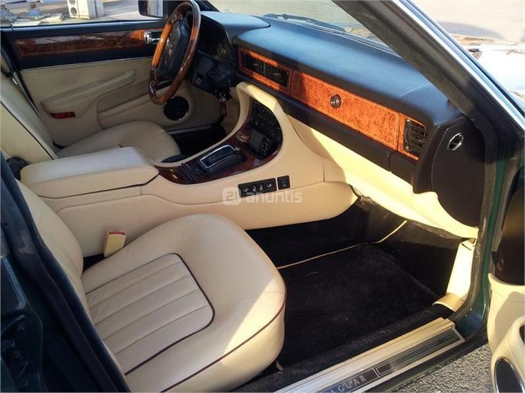

and there is another one with 12000 km 1989 but i do not like the front headlight, but i wanted to post an image of the interior that is really beautiful. I am also looking for an aston martin db9 2007-09.
I want to know what do you guys think about the cost of maintaining this car and driving it 5000 to 10000 km a year?

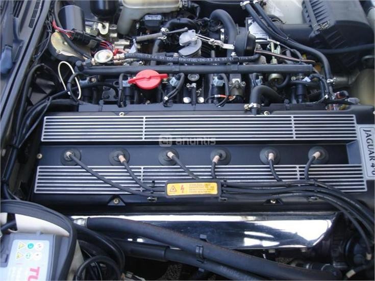

Here i upload a few images of the engine.

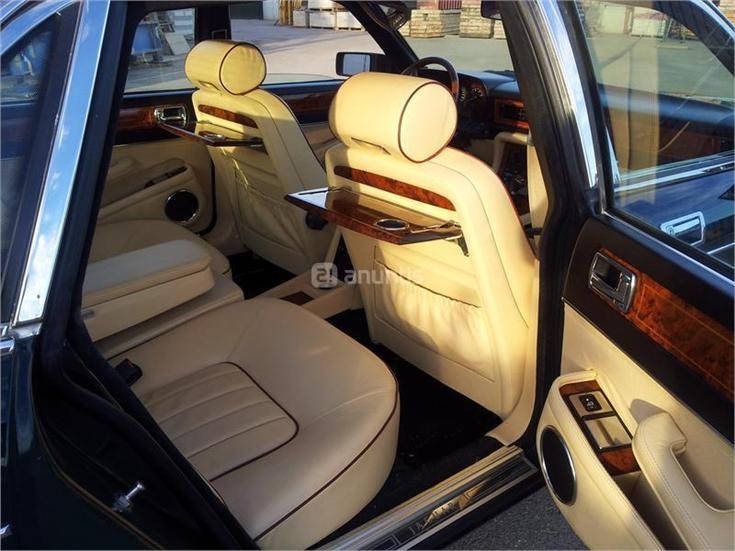

I have a Jaguar Sov, 1990, manufactured in July of that year. It does not have seat piping or picnic tables. May I suggest that you property identify the correct model first by investigating the manufacturing date which you will find in the engine compartment on either the left hand side or RHS inner wing. Have a look opposite the air filter. They-the date- is stamped into the metal.

The interior with the contrasting piping appears identical to our '93 Vanden Plas, except our car has an airbag in the steering wheel. Even the pattern in the leather seats is identical to our VDP.
I don't think you would like that car at all. Please give me the seller's phone number and location so I can call him to complain about how clean and beautiful the interior and engine bay are. :-)
