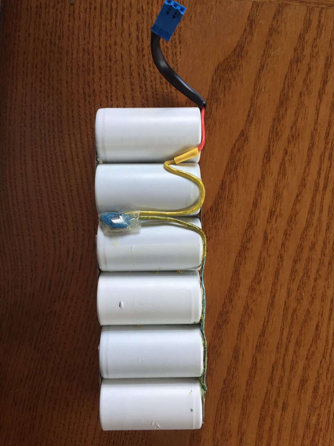

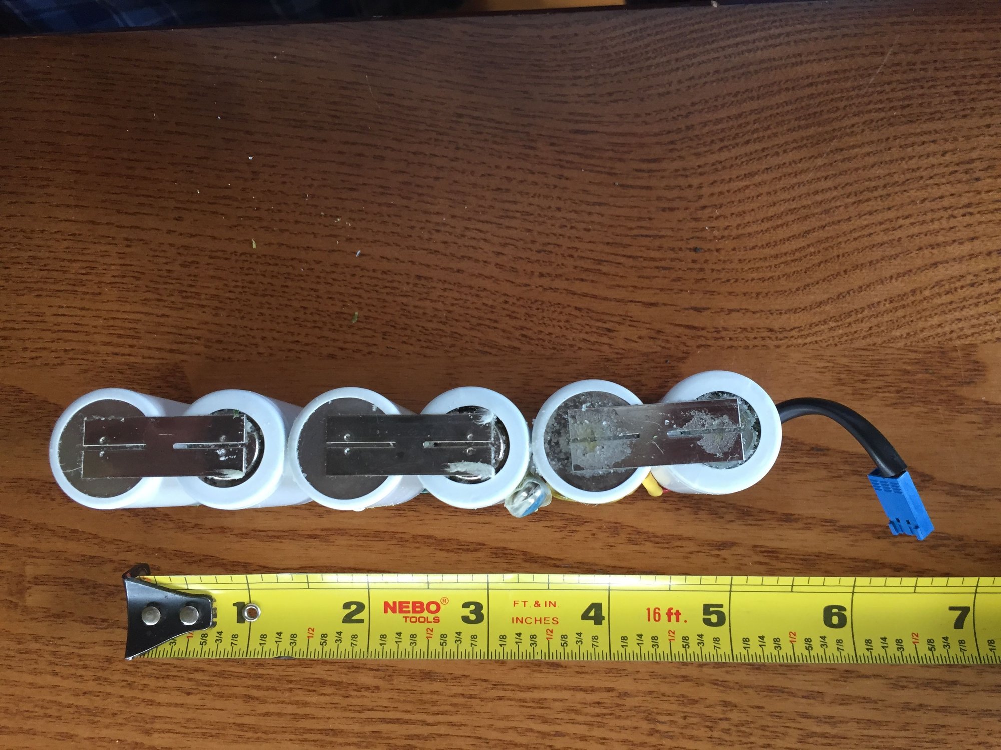

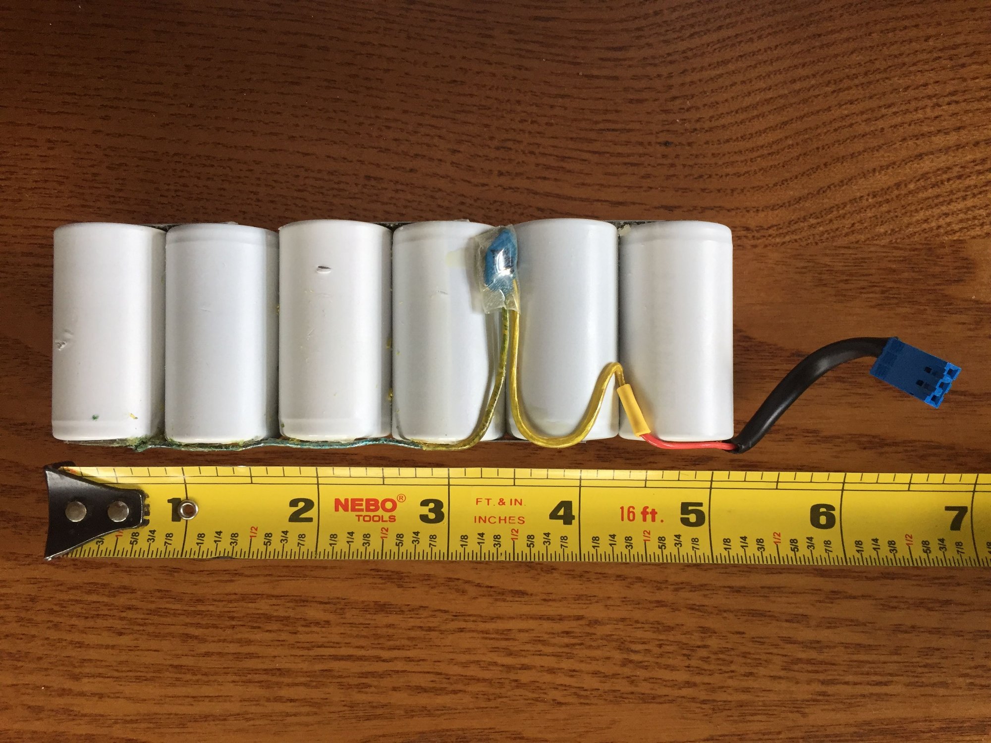

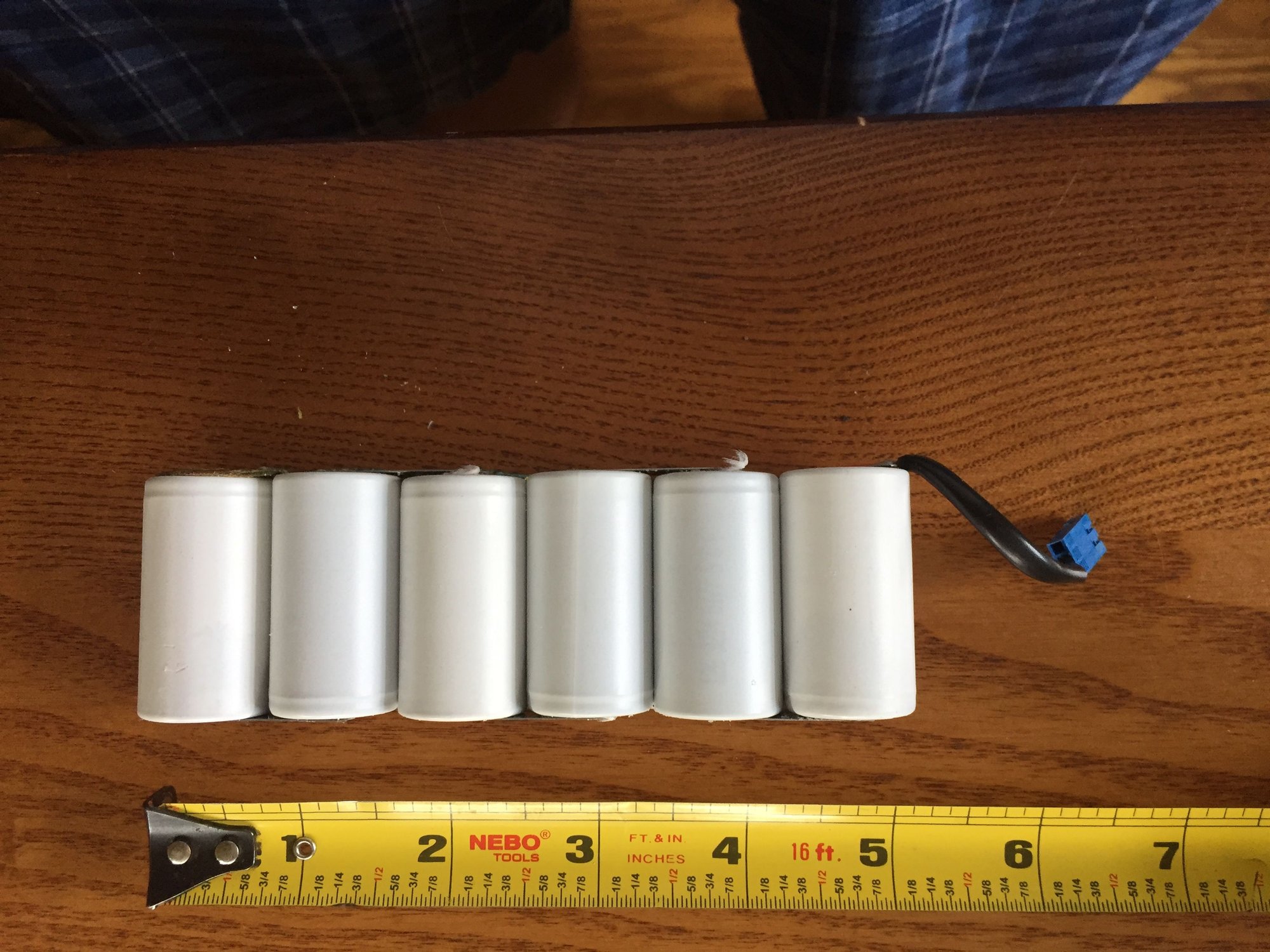

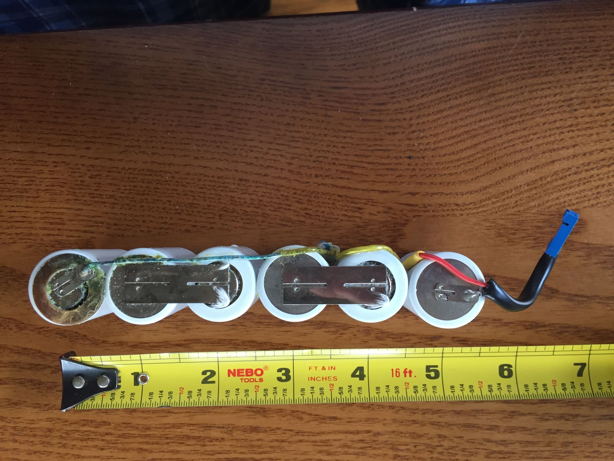

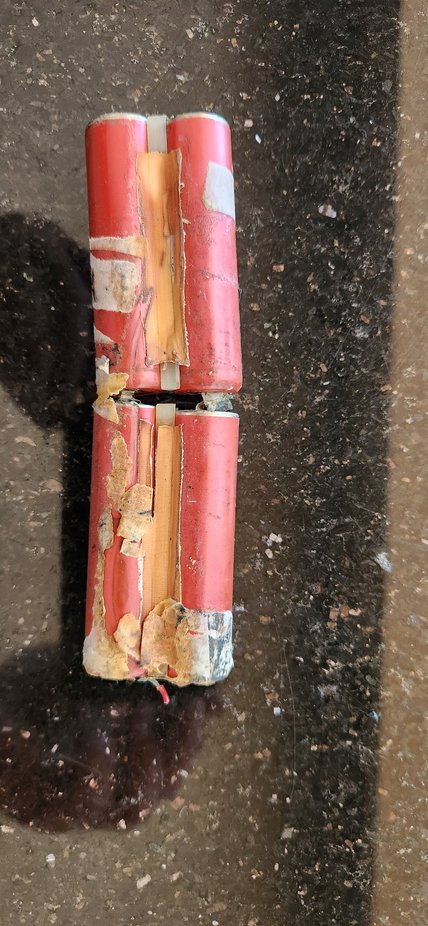

So, I'm in the process of getting my PDU up to speed with the help of this really great thread. So I have a question on the PDU battery replacement. I've seen people here suggest the 7.2v battery as a replacement. When I received my unit recently, I pulled what appeared to be a factory battery, it was wrapped in electrical tape, and then another thick layer of protective plastic wrap as well. See pics of what was left over afterward. As you can see this is set up with two nicad batteries in series, with an exra two in parallel for more longevity. So if this is the case, its only a 2.4~2.5v battery. Not sure how you guys got to 7.2v. This of course assumes this is the correct battery, but the connector seems correct and it fits perfectly in the battery compartment, so thoughts here?

I have the FDS2000, the same as your Jaguar PDU, just toke out the battery and what i know is 7,2 Volt/ 4000mAh, no doubt.
It has 2 x 3 Cells in series, 1,2 Volt/ Cell.
I also i'm looking for the CD's and FDS2000 manuals, anybody have a link where i can download these??

It was not the original battery, the previous owner replaced it with this 2 x 3 cell 7,2 Volt one, from what i've saw in the Jaguar training
PDU introduction and PDU module II, there on page 4-2 the battery is made of 6 cells next to each other.

Sorry just the Jag , no Ford. So if there are six cells, they could be in series parallel like mine were, so maybe 3.6v?...I'll take a look at that page.

You need 6 cells in series to get 7,2 Volt, not parallel, and of course not bigger then your space can hold.
Some used a battery for RC cars, i think mine lookes like that, longgg ago i used the same battery for my RC cars,
they where Nicad, and now the best alternative are NiMh with more power (mAh).
Fran,

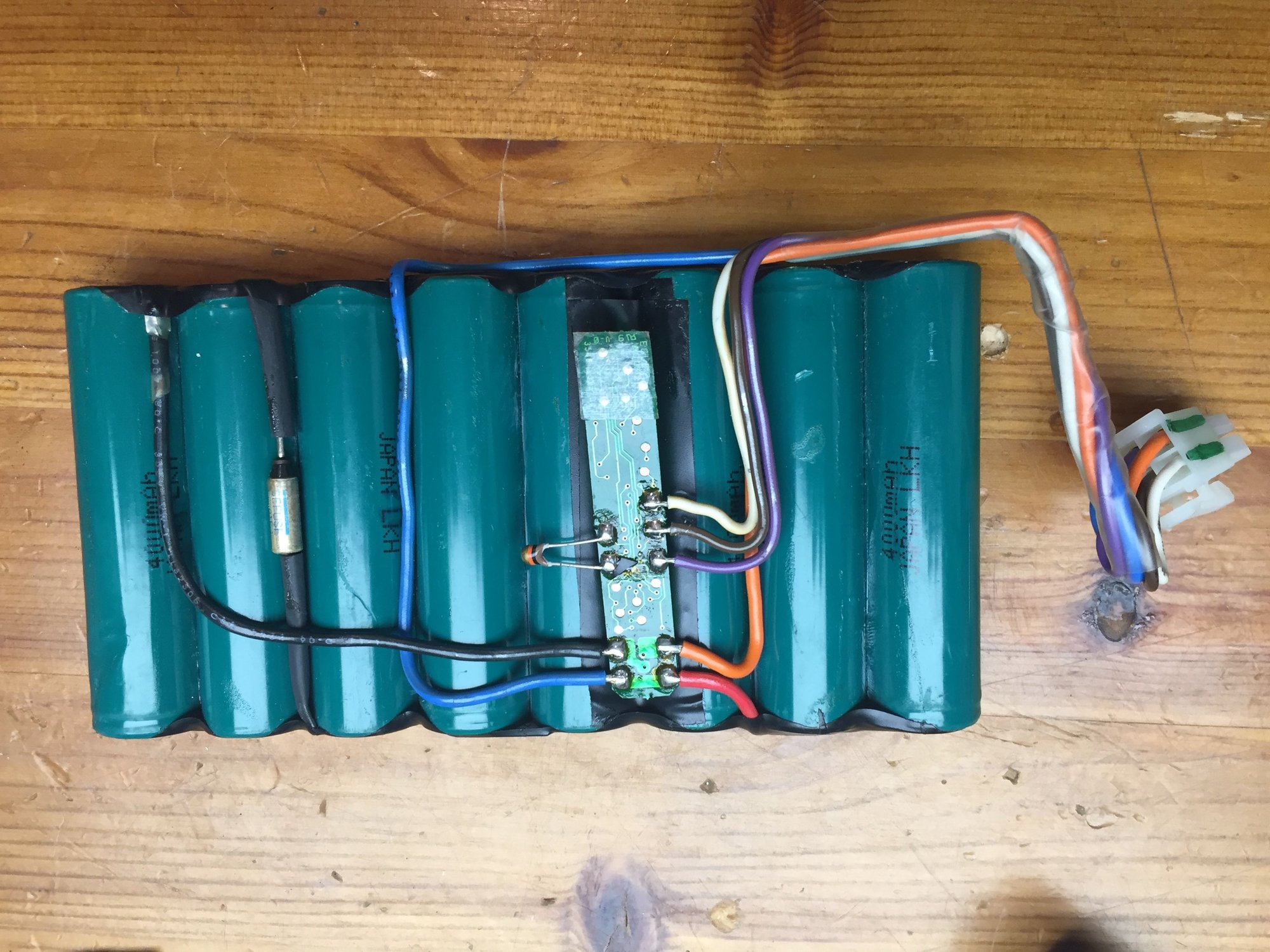

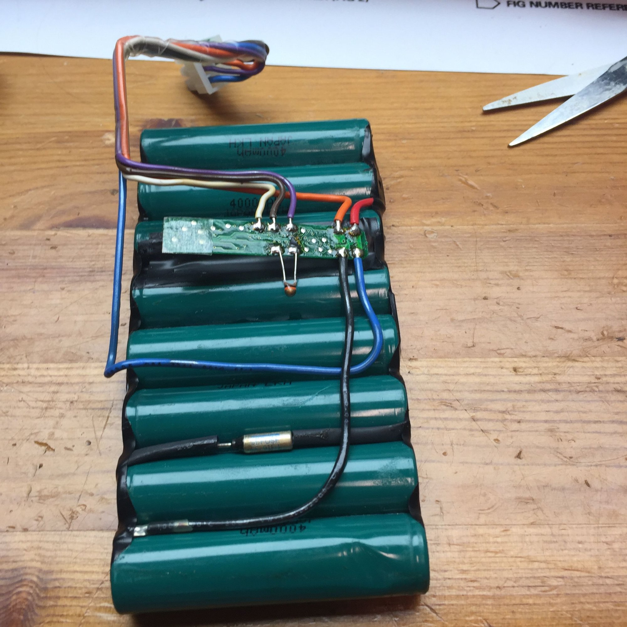

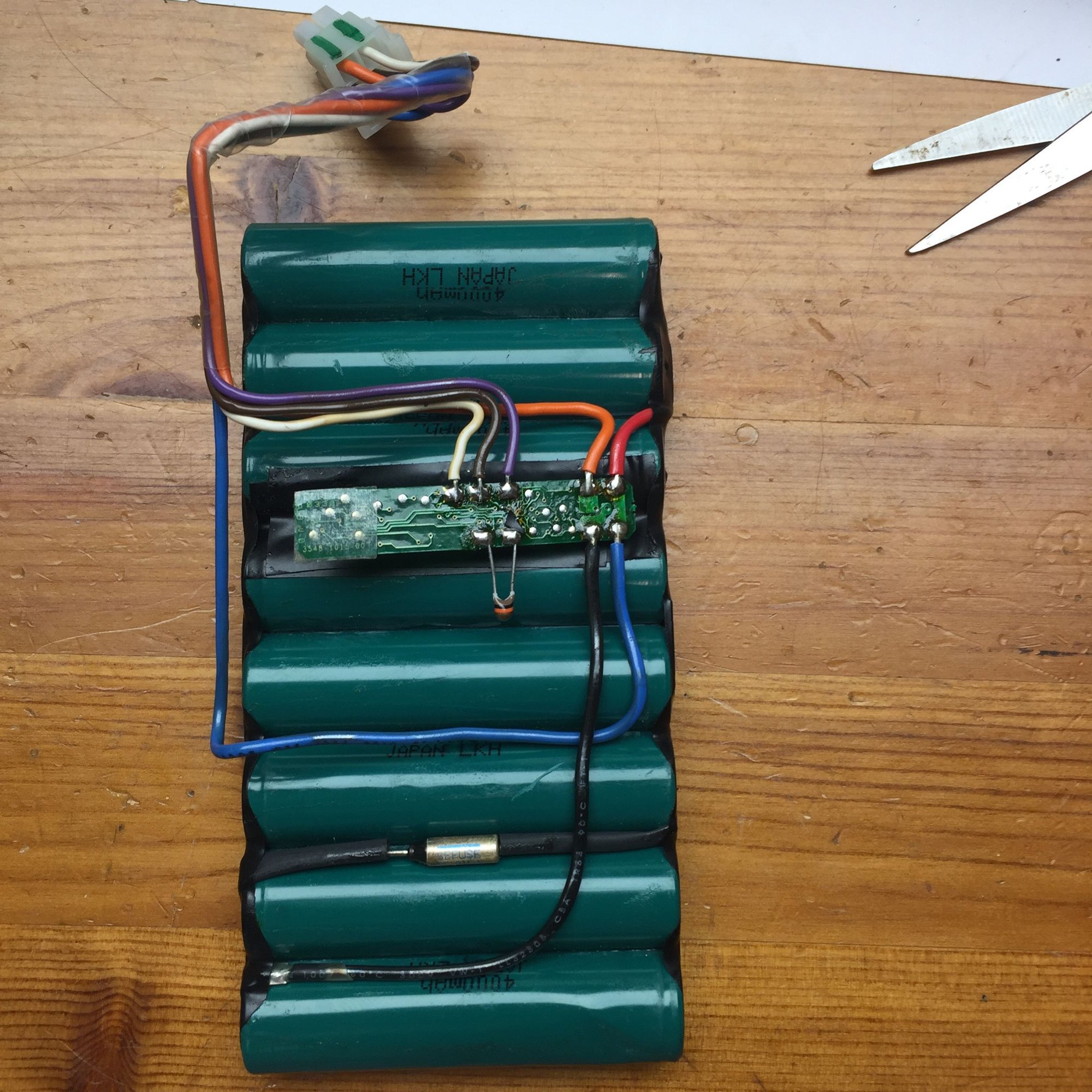

I can share pics of the battery pack I made for my PDU
i had to transplant the wires and circuits to my battery pack from the original one.

Likes: 1,750
From: Arlington, VA
Actually, that was for my WDS.
the PDU Batteries were these:

Seems to be quite of bit of variety with these batteries...But obviously the 7.2 works so I'll go with that..ty
