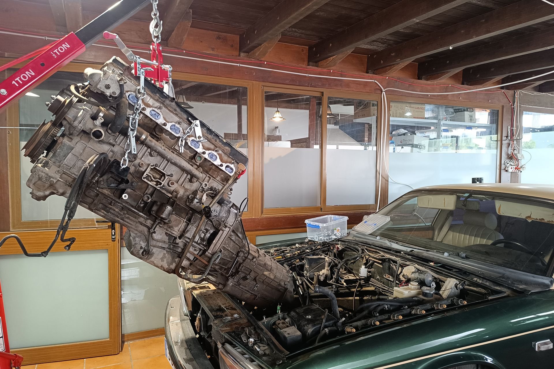

Hi Joliette,
I can't tell in the photo how your load leveler is attached to the engine, but it will help if you can attach it in a lengthwise manner that will give you the ability to tilt the front of the engine up as you lift it out, Your hoist looks like a newer version of the one I own, which is perfectly capable of lifting both the engine and transmission together.

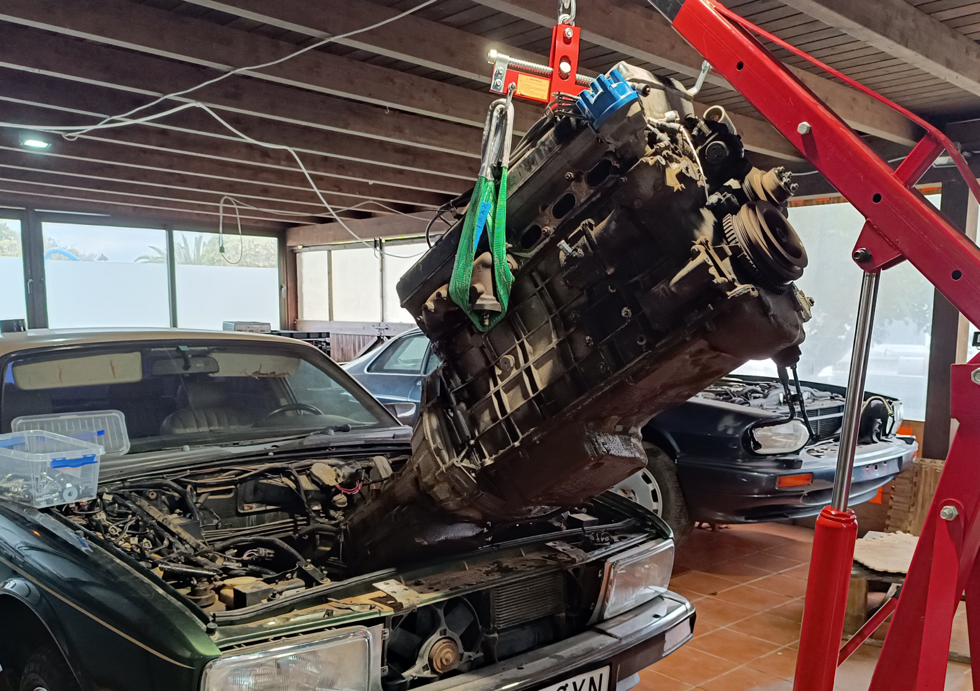

Thank you guys for support, so in the end it was way easier than the dimensions would suggest, the engine is way lighter than diesels I usually have to deal with. So my red one gets a new rebuilt gearbox, my green one gets a new engine and gearbox and they will both be ready for next 40 years of fun.
I fixed the crane on rear exhaust and in front I rotated the engine mount and fixed it on that so it was naturally forward backward balanced and tilting. It touched the engine bay on the front as I was sliding it out, but I removed the grille so it does not get damaged and it needed only slight lift by the gearbox to clear it. I was able to do it with my missing muscles so, weights really not much.
When I will be putting it back, I will move the front attachment to rear engine mount screw (one is enough). I was just too scared seeing the size so as always overdid it.

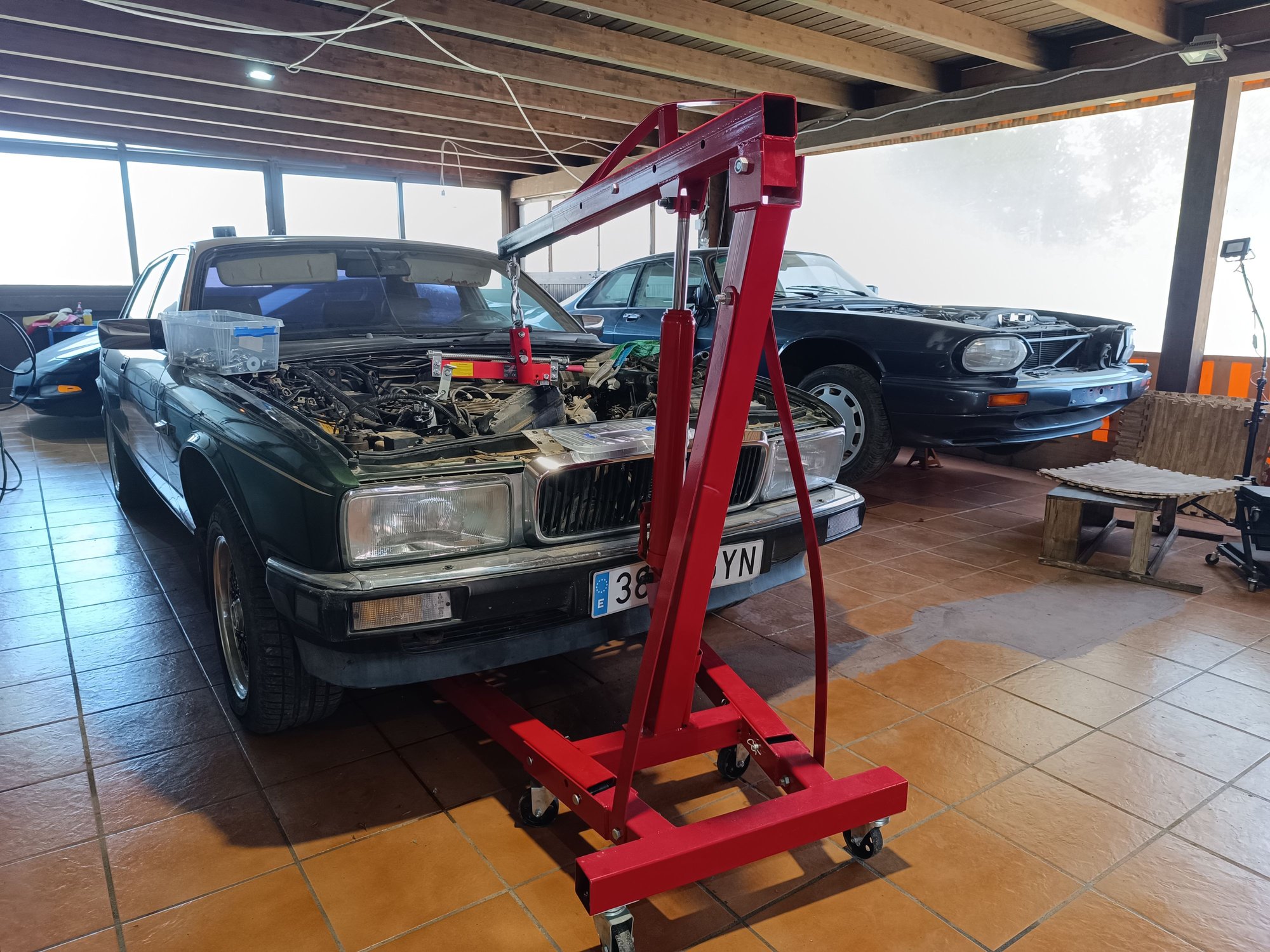

View from the other side, for future references. Maybe it will help someone.
