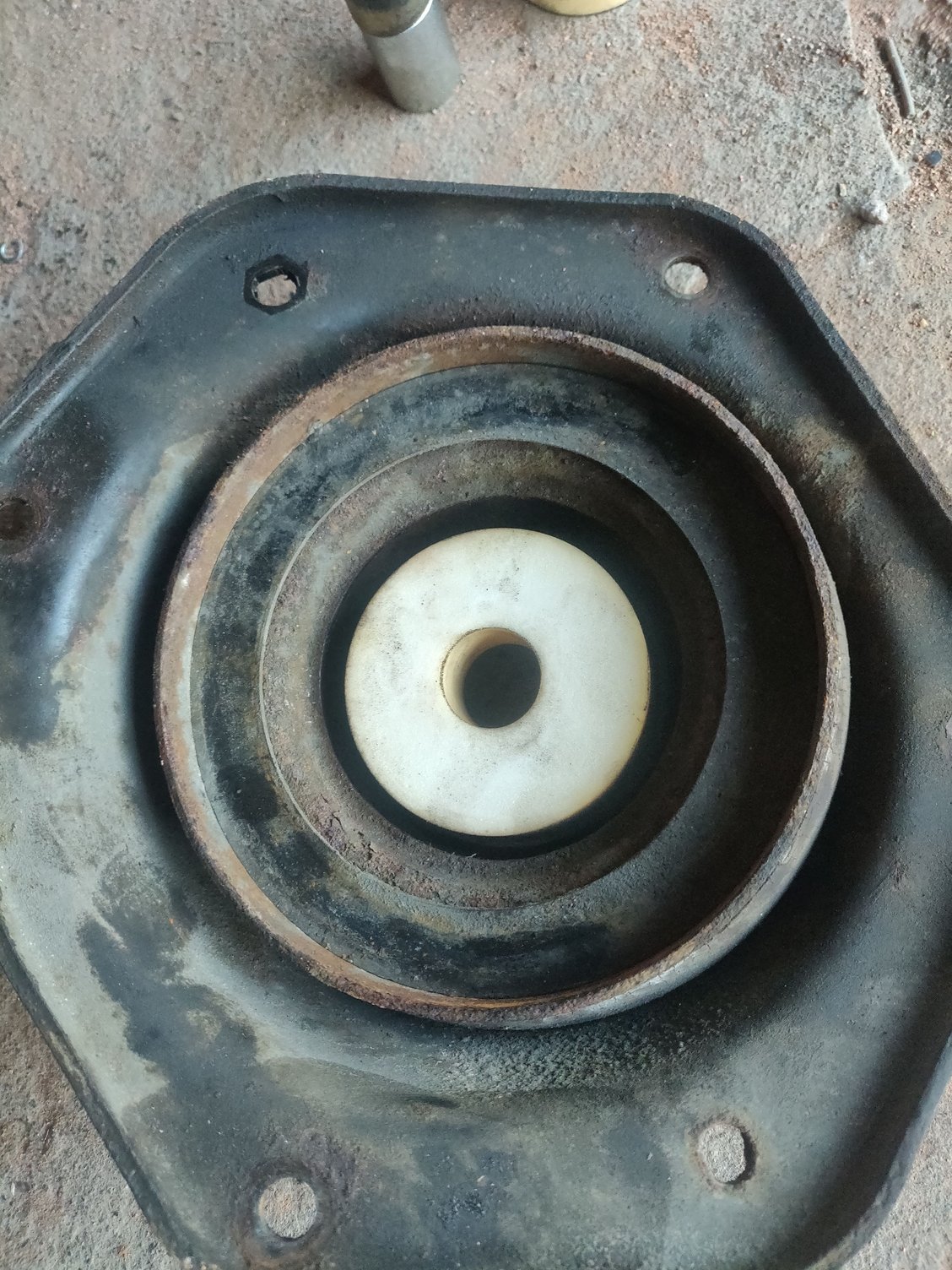

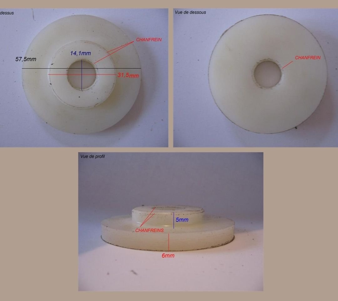

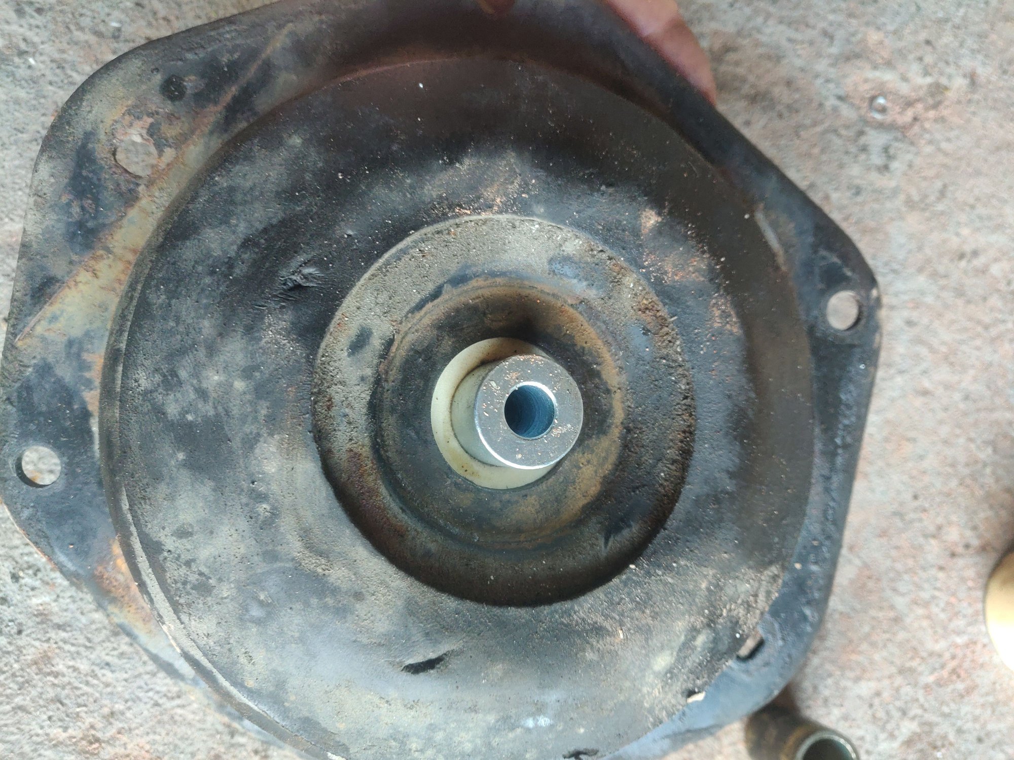

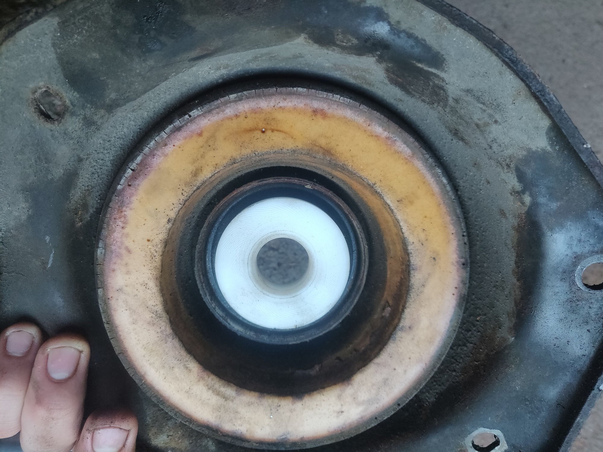

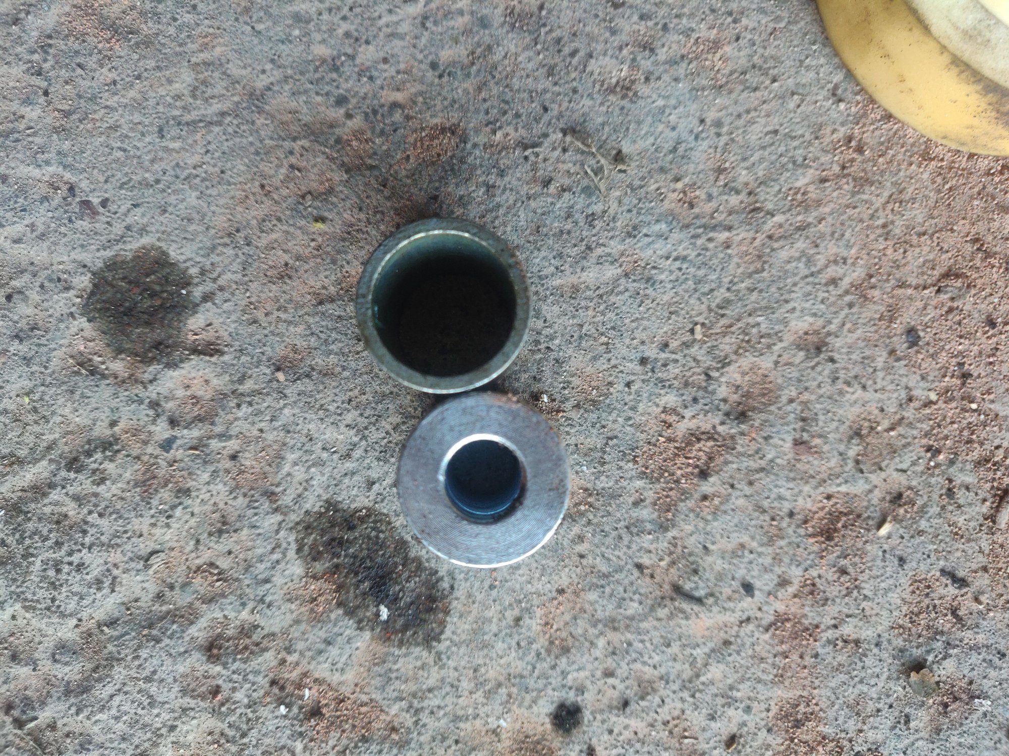

Today I dissembled the rear SLS suspension and took a look, i have bought complete kid of x300 bushings for the rear so I compared it to the bushings from the xj40 SLS suspension and they are identical? Only difference is the thickness of the damper. Then I shouldn't need the custom made plastic guide thing that you need to use the original SLS top mount with none SLS dampers?
here is some pictures so that you can see what I mean :-)
Here is with the centrum guiding thing. But shouldn't even need it because it will be the exact space to make around as original?

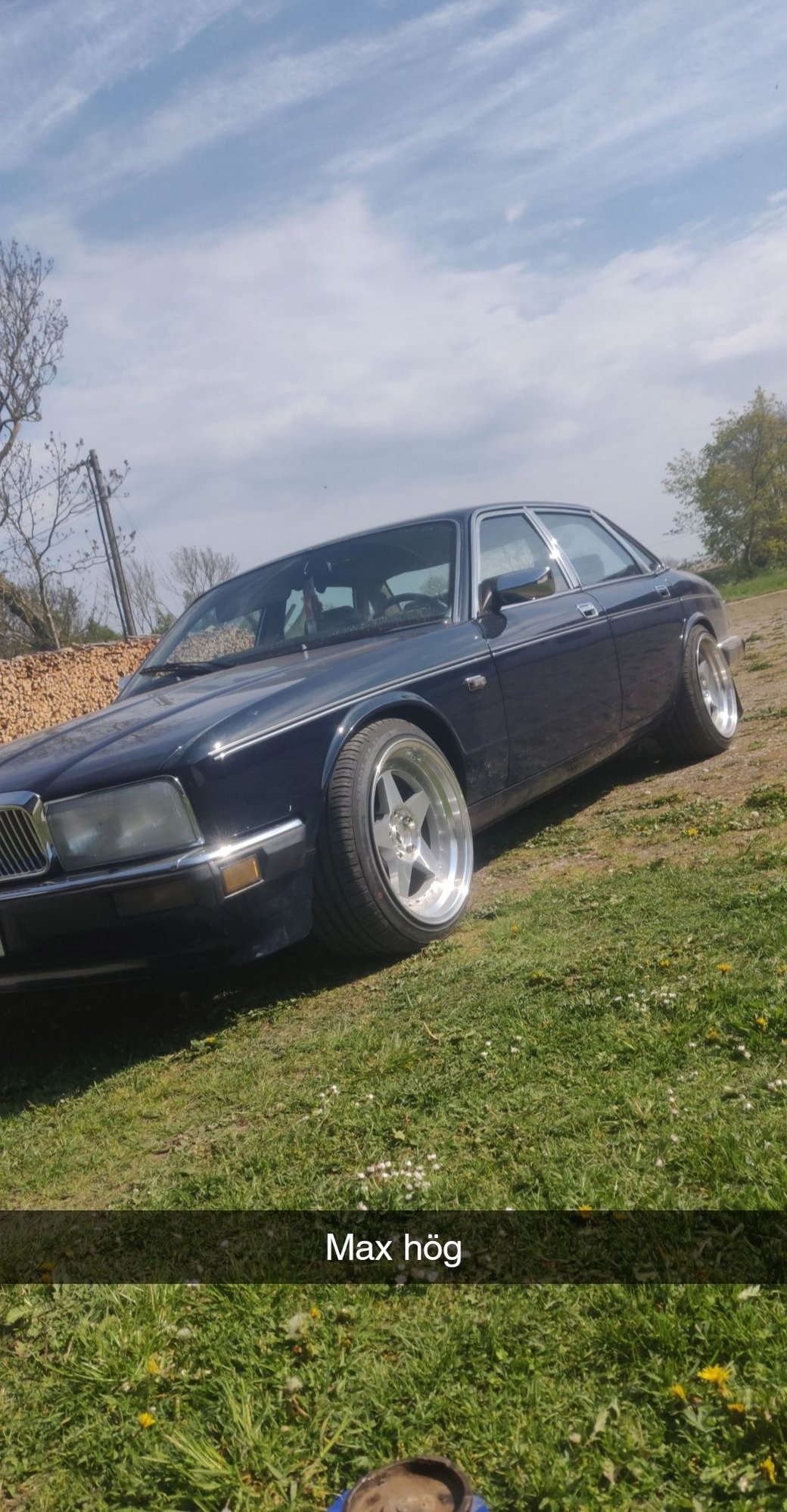

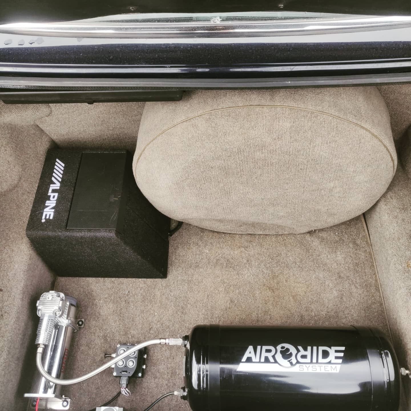

No response but gonna write anyway because it may help someone one day. Did not need the custom made plastic thingy. The topmount for sls was the same as for x300 because the bushings was the same as I wrote. I only needed to modify the lower mounting as I new I would need, and the front fit without any problems. So I now have an XJ40 with air suspension.
Adding a load of pictures if someone finds this interesting. Many may see this as destroying an original old jaguar but I really think this makes a more modern lift and look on the car and are very pleased with the result :-)
