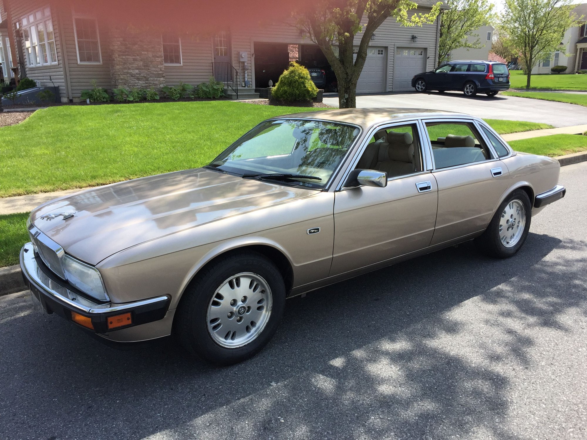

New to this group, but not new to the forum. Stumbled across a 1994 XJ6 near me with only 48k miles, and being sold by the family of the elderly second owner since 1997. PO had only put about 16k miles since his purchase, and had recently had it repainted and other service work done. Paint job was a budget job, but adequate “driver” quality. Interior is clean, with only a little wear on the drivers outside bolster.
Issues I will need to deal with include A/C not blowing cold, a CEL for O2 sensor, a nasty scratch from being keyed, and just a few appearance details to deal with, such as some wheel corrosion.
One thing I want to understand better is the braking system on the ‘94. The brakes work, but it seems to need far more pedal pressure than I am used to in my XKR, and other cars. Also, the throttle pedal takes a bit more push as well. Lubrication?
I am sure other things will come along, and will tap into the vast knowledge base of this forum as I have with my other Jags.
Looking forward to being part of this XJ community!
TC
