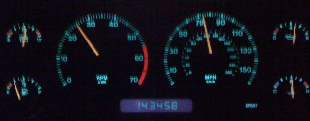

On these later XJ40's the oil gauge on the dashboard is pretty much just for show.
But on the earlier ones (90) it looks like this while delivering pressure.

An oil pressure sender which displays the oil pressure in the engine on the gauge thus fluctuates with engine speed was fitted to all XJ40s and early X300s.
Unfortunately, it is very unreliable, frequently reporting low oil pressure problems when real oil pressure problems are almost unheard of in the very robust AJ6 engine.
This led to a lot of disgruntled owners and warranty claims. Jaguar's solution was to offer a simple pressure switch as a replacement which would register at the mid point on the dial provided there was some oil pressure. Jaguar now no longer offer the original pressure sender, only the pressure switch.
