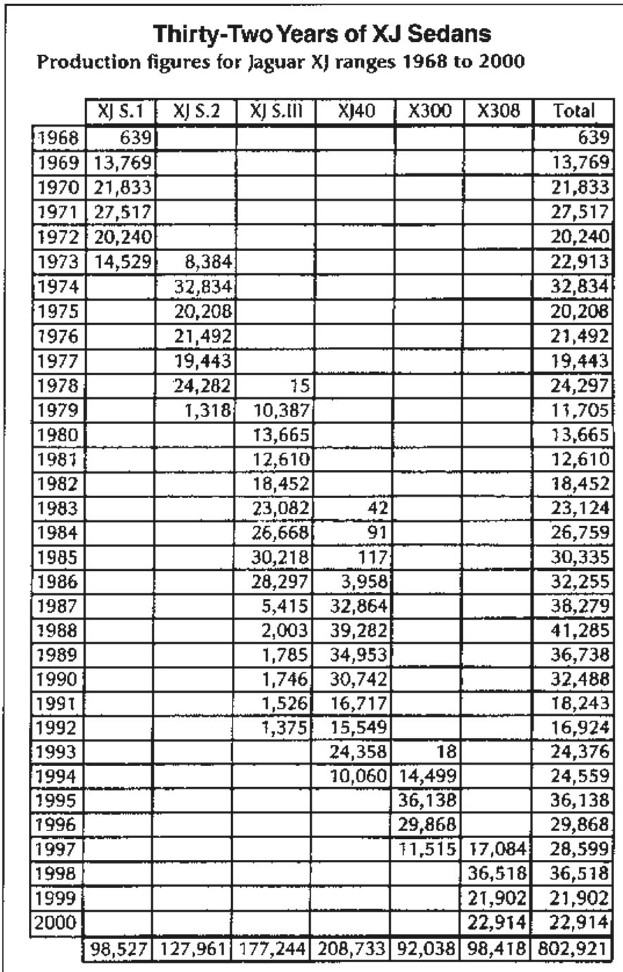

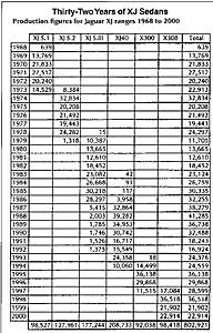

The XJ-6 and 12 were developed and improved as they "grew up" and therefore the "Series". The chart below explains all the Series. The XJ-40 is considered "Series 4" unoficially.
