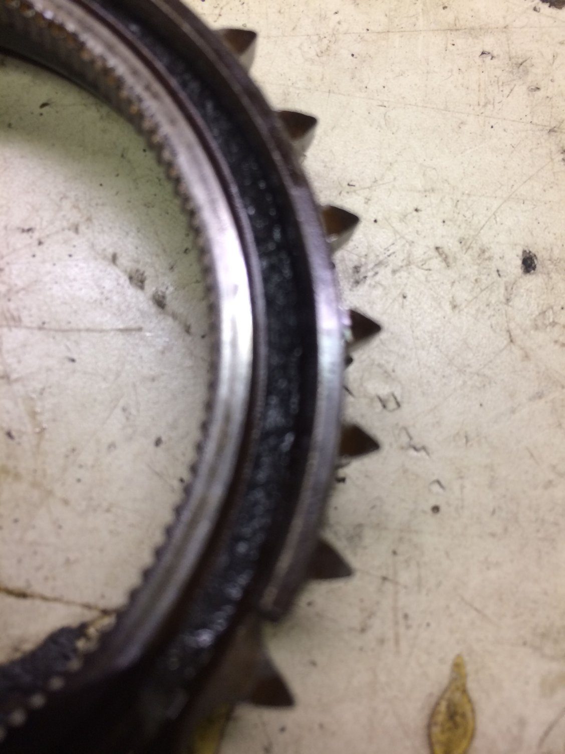

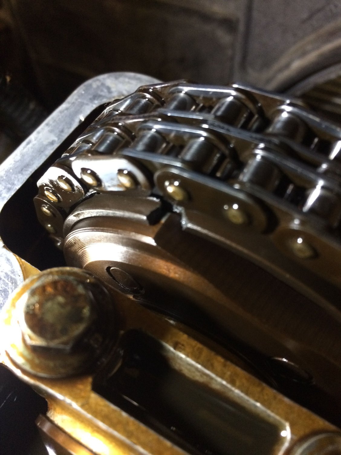

Hey all. You'll be glad to know that my head gasket change was a qualified success. I refer you to the last entry in my thread "94 no start." I reassembled it and not surprisingly had a coupe of hiccups, one being a leaky injector causing Very hard starting. The other was fairly scary (in terms of the cars' future as seen at the time). I had a piece of the intake cam gear literally Break off and fall into the various gears and chains down below it. I believe that the gear was previously cracked judging by the color of the metal in the crack. I am not really too surprised since this car has a rebuilt title and was abused beyond being totaled. Anyway, the ruckus as that gear chunk was being chewed and tossed around was, as I say, scary. When I installed the replacement gear I rechecked the timing and all seemed good at that time.

Where I am now is that maybe when that gear chunk went loose, it knocked the lower chain off a tooth. I suppose that this would be easy enough to check on the timing mark. But I didn't do it yet.

the missing chunk is dead center of the photo. Cant imagine how this happened!
