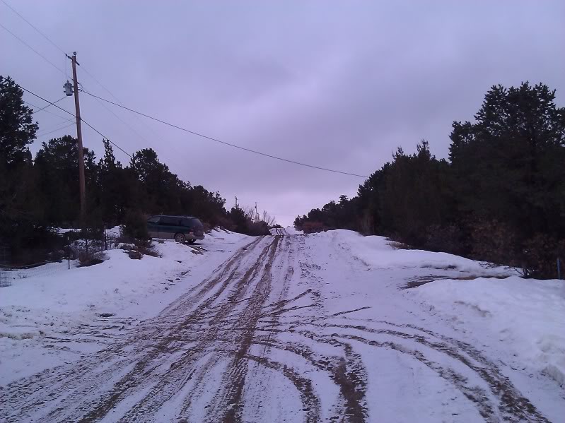

Sorry for not getting back. It was an easy install and it fixed the issues. Nice charge and bright lights even at idle.
I think the air pump is slipping with the clutch engaged now (causing a slight squeal on startup), and may have to see if the air gap is adjustable.
But thats for another day as its been snowing and my XJ is parked until the melt. It might get down the hill to work but not back up.
