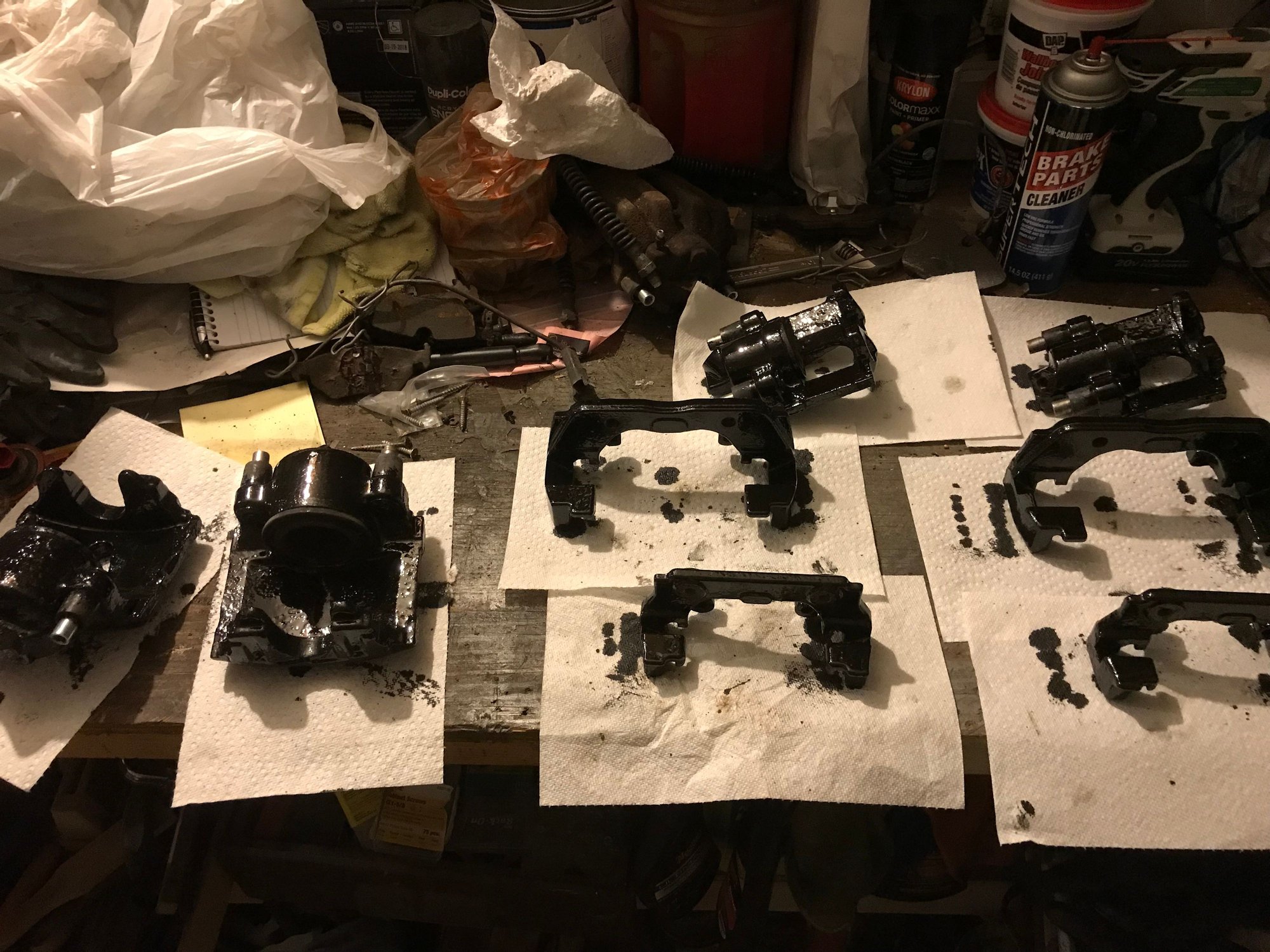

Springs finally here in MI. Time to put on the new 5 spoke wheels that will show more of the rotor/caliper.....so more work for me. I cleaned the brake parts up, wire wheeled the crud off and now I am giving them 2 coats of POR 15 then prime and paint. POR 15 works great at keeping the rust from resurfacing and/or taking hold.Hpefully I'll have the wheels mounted next weekend.
