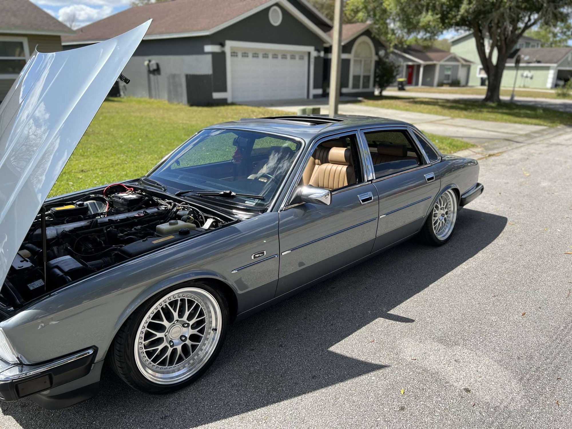

I’m going to try and be as detailed as possible for everyone who may be able to help. Please fully read as I did say a lot here. THANK YOU!! anyways yes, stupid me, I know. My oil sensor light seemed to fail me this time. So.. I was driving and all of a sudden there was a very loud flappy/spitty knocking kind of noise , almost as if there was a rubber flap in the wind along with white smoke spewing from under the car. I pulled right over , checked the oil, and topped it off.
The next day I was driving the same noise occurred without the smoke. I pulled over to inspect and I also noticed a vacuum hose right by the fuel rail that was disconnected so I reconnected it (this could be irrelevant just figured I’d mention.) The car made the same weird knocky noise about 3 times again. On 2 of those occasions, I had my defrost on and the noise occurred, it oddly went away when I turned the defrost off and I kept driving as normal. Now, I pulled into a parking lot and the car suddenly locked up as if it threw its self into a safe gear. Even if you were to floor it, it wouldn’t have moved much or maybe not moved at all, I just didn’t want to cause any more damages. I’m aware of limp mode but this car is not driveable at all in this condition.
**REWIND a couple days ago, yet still after the car initially broke down from no oil, I replaced the valve cover gaskets. I noticed a puddle of oil in the valve plate pooling to the passenger side… might be normal? I also believe I may have put too much oil into the car after I initially broke down. And potentially could have been riding around with too much oil but there wasn’t any major oil leaks nor any white smoke. After the car broke down in the parking lot, I drained the oil from the pan and cleaned out the oil in the spark plug holes, and yes there was a good amount of oil on some of the sparkplugs and in the holes 3,4,5, and 6. So I drained the oil , cleaned plugs, dried holes , put it in drive and it would go but then aggressively lock up. I re parked it and tried putting it into gear and the car wouldn’t move, same with reverse. If I was to cut the car off and turn it back on it would drive and then lock up again.
It starts and idles just fine. Hopefully I added enough detail and stuck to the point I’m just stumped on this one, not sure what to do next. Anyone who responds to this is a major help!!!
