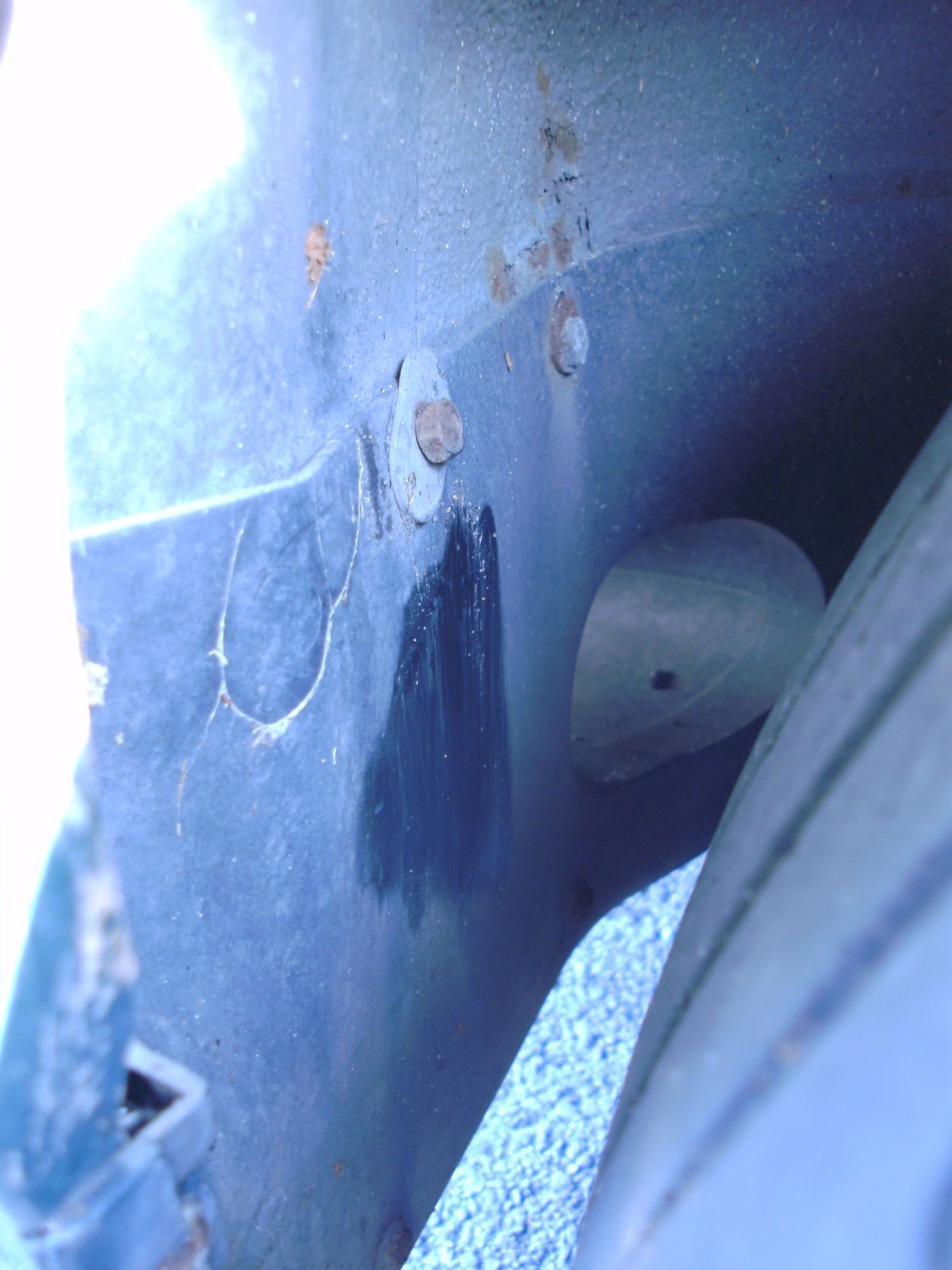

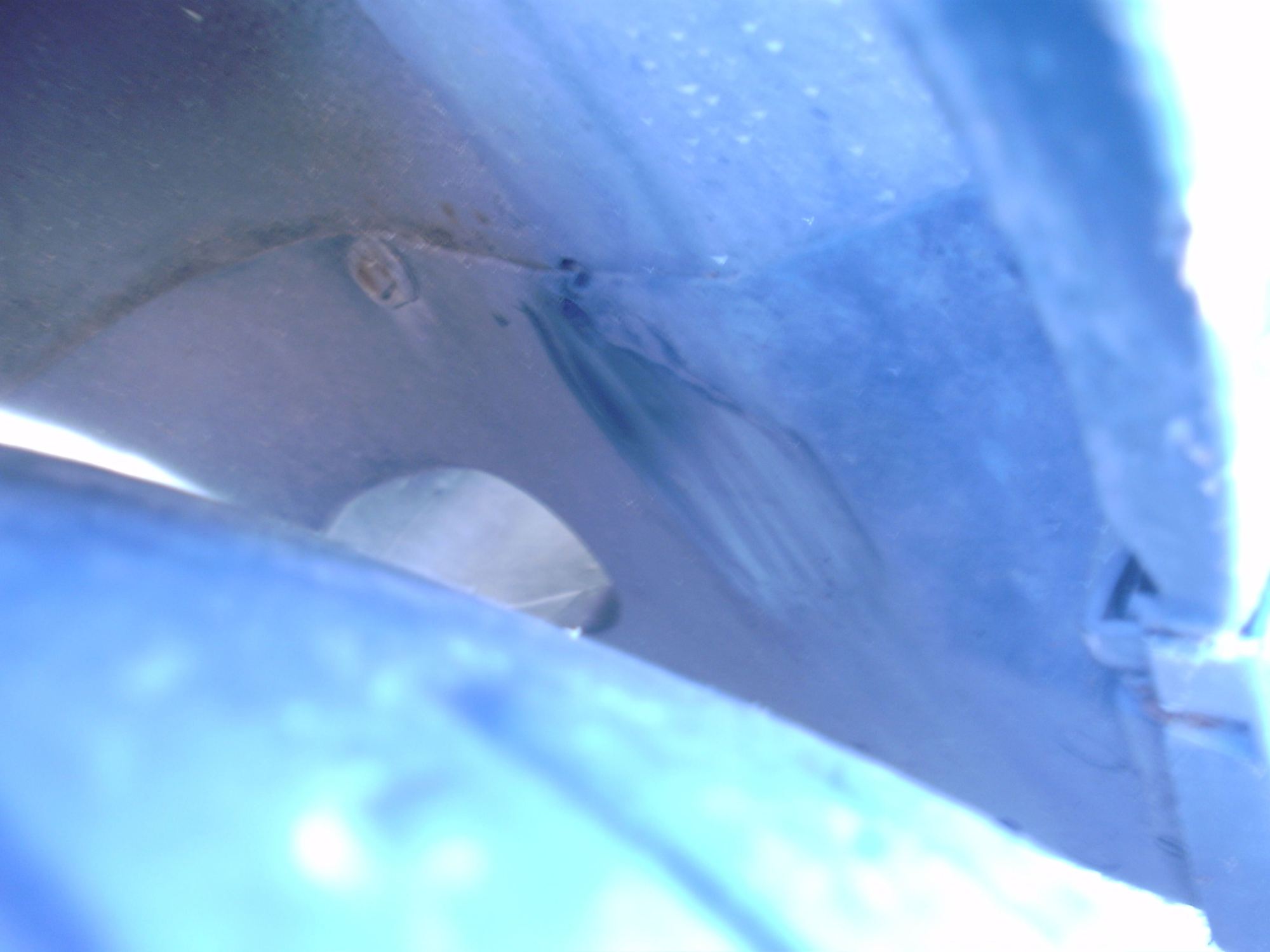

There is nothing loose, car just flew through MOT, note tyres rub on both sides, and has done since purchasng the car. see pics

As with your 2nd comment I wanted to try in the dry and wet (hence the late reply waiting for wet weather). I painted some fine lines on the scuff marks on inner wings and turned wheel lock to lock, the result was no streak marks so tyre was NOT touching, After waiting for wet weather I repeated the expreiment and on both sides the tyres rubbed the paint off, I conclude there must be a problem with the tyres in wet waether.
So it's looking like I need new tyres
