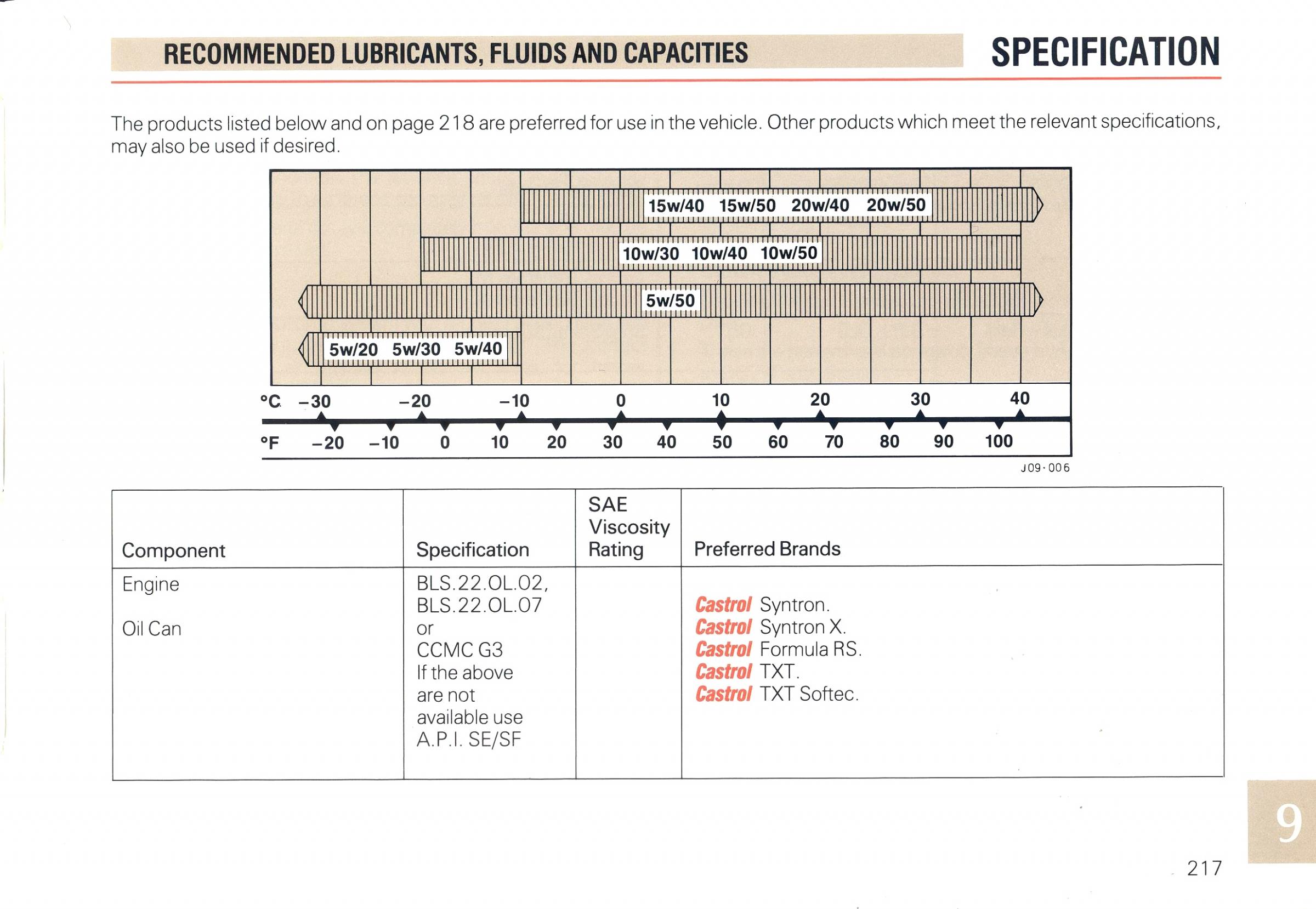

Old Aug 13, 2013 | 03:39 AM
Getting the Owner's Manuals with a used Jaguar is rare. When it comes to the XJ40, they are approaching collectors item status!
(click on the images to enlarge them)
Old Aug 13, 2013 | 06:54 AM
matts89xj's Avatar
Joined: Aug 2013
Posts: 187
Likes: 13
From: Ohio
Attachment 50838
Attachment 50839
Lol no doubt, thanks for the help! I'm not the original owner or anything and having owned 80+ cars I find it very rare to get an owners manual to anything lol.
Old Aug 13, 2013 | 09:27 AM
Mikey's Avatar
Joined: Oct 2009
Posts: 11,057
Likes: 2,272
From: Perth Ontario Canada
Attachment 50838
Attachment 50839
As always Graham, to the rescue!
