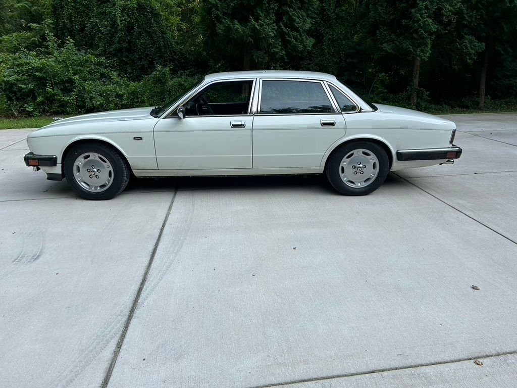

This is mine-
I had the wheels anodized, and got new tires in one go--
Too bad I couldnt be bothered to wash it.

Originally Posted by jerry_hoback
This is mine-
Jerry, she's a real Goddess!!!!!!!!!!!!!

I put the same X300 Dimple wheels on our '93:
Cheers,
Don
Cheers,
Don
Another beautiful Princess....
Those wheels look great!
