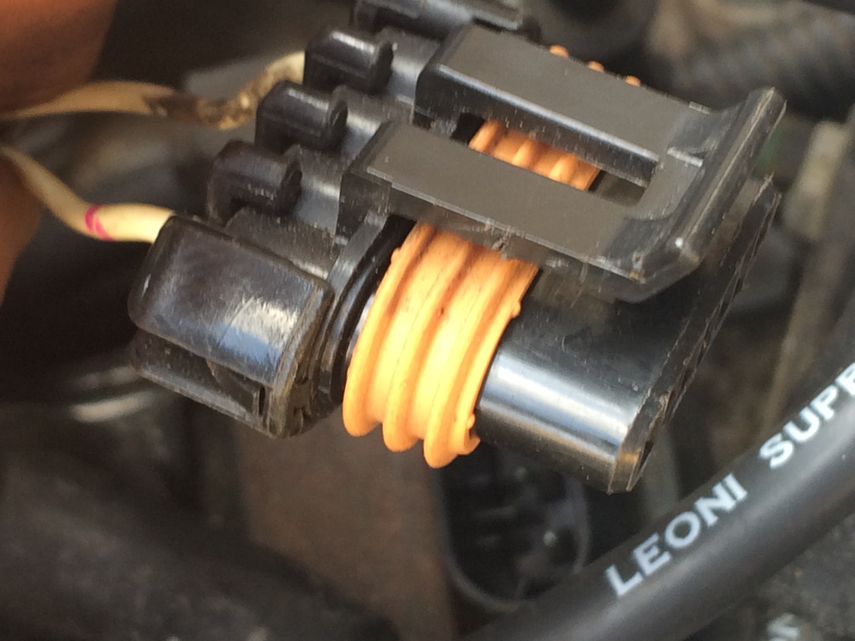

Also have been trying to identify & find the plug that plugs into the HT coil as one is faulty and one bank keeps cutting out. I have fixed it for now but it needs a new one.

Hi Charles,
I'm not sure I understand the issue with the ignition coil - has the connector plug on the wiring harness to the coil or ignition amplifier failed? If you can post a photo perhaps we may be able to help you identify it.

The HT coil problem is the connector on the loom which is a socket not a plug, apologies my first post was misleading. I have bent one of the pins on the coil over so it contacts when the socket is plugged in but this is a short term fix.

Hi Charles,
That connector is a type used on Ford vehicles and you may find it in this catalog:
http://www.motorcraft.com/servlet/Bl...lob&blobkey=id
I can't recall which company manufactures that style connector, but the Jaguar connector OEMs and brands include Econoseal, AMP, Amphenol, Augat, Deutsch Group SAS, TE Connectivity, Lucar, Modu, Molex, Motorcraft, Multi-Lok and Tyco International. If you don't find the connector in the Ford catalog, try searching the online catalogs of the above OEMs.
BTW, is the car in question your 1991 XJ81 or your 1994 XJ12?
