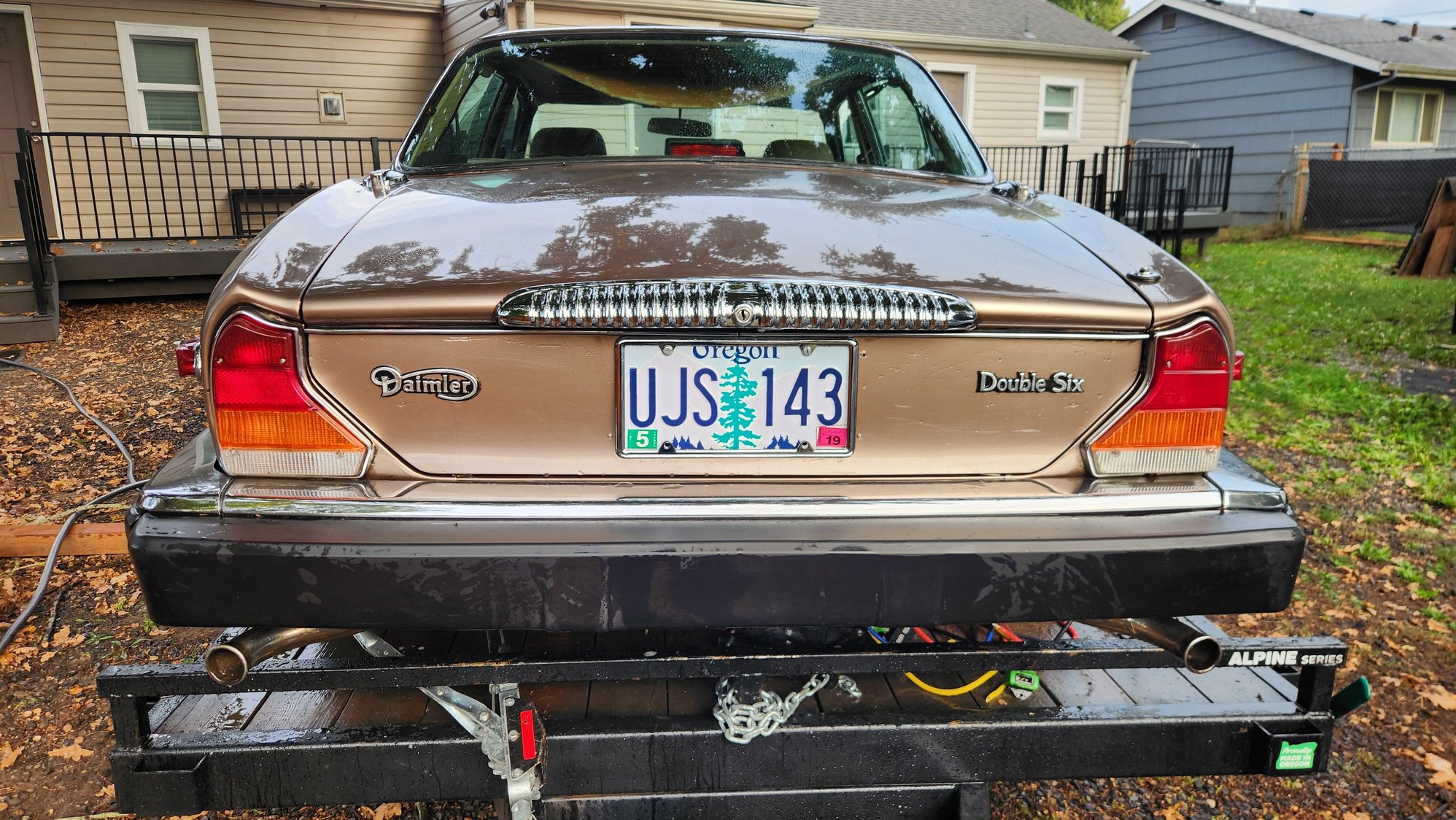

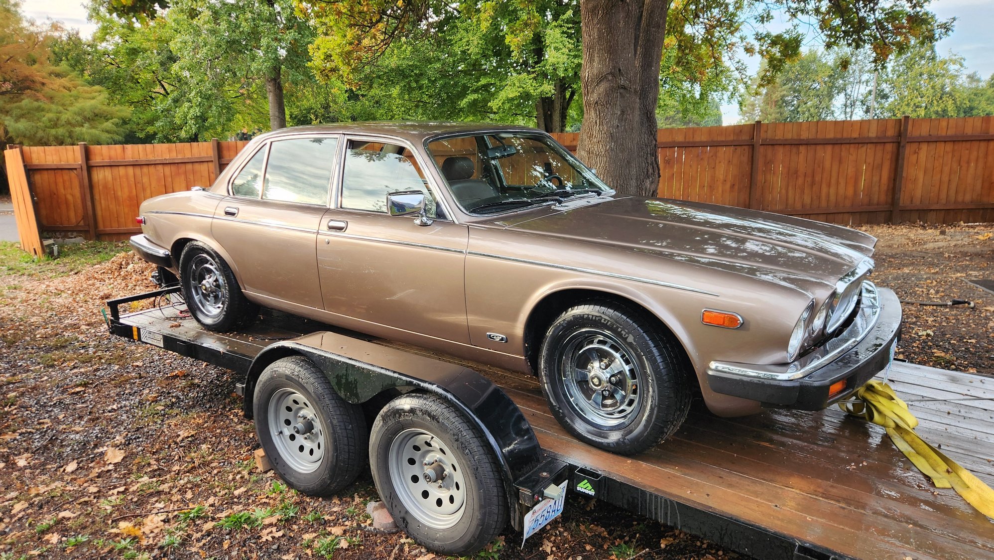

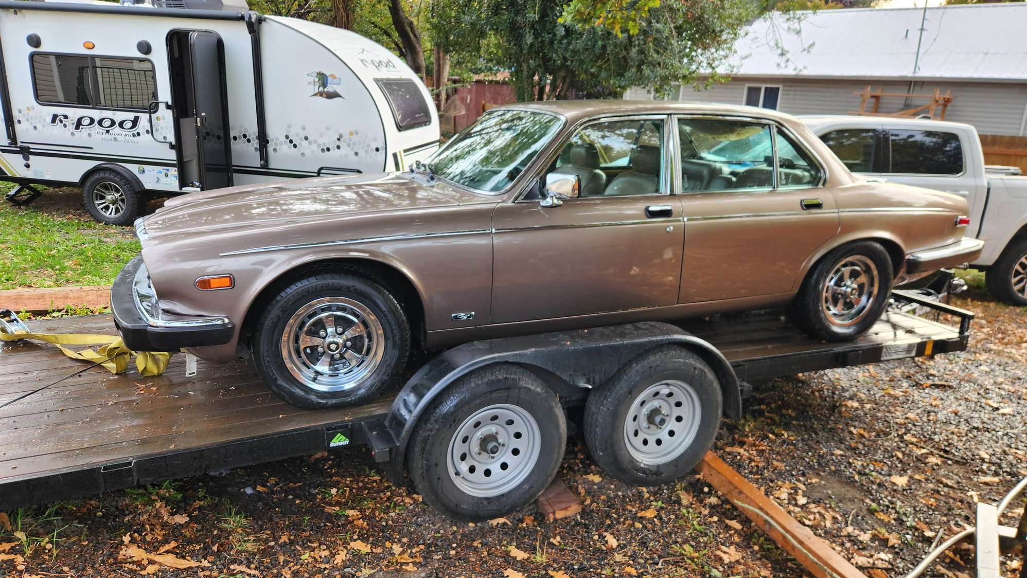

Hello All, I picked up a Damlier Double six in Oregon a few weeks ago with 58k miles. It is a pretty rare car around these parts and was imported at some point but I don't know yet from where.. It is also a LHD car. The car had sat for a while and I didn't have too much trouble getting it running. I then made the mistake of degreasing the engine compartment and now the car is dead, dead, dead! I have spark and fuel pressure. What I don't have is injectors firing. I have gone through everything, all the relays, all the grounds. I did multiple jumpers on the main and the fuel pump relays to bypass things that might not be working. I swapped out multiple ECU's to no avail. I even have a Lucas Epitest unit that I have never had to break out before, but in this case I decided to see if it was useful and it is not so much so far. Plugging it in to the ECU pigtail, the first test is, is there power to the ECU. The Epitest has no reading, but I do have power to the pin on the pigtail that the manual says to check, so maybe the unit is not functioning. I am also running into problems with what is in XJ manuals and the Epitest manual and where things are at on this car. The ECU pigtail in the car, does not have some pins that are showing as should be present in the epitest manual. What I believe are the main and fuel pump relays are not where they are supposed to be according to the shop manuals. I have checked an cleaned every plug, every ground and ensured every single critical wire was properly hooked up. I checked and cleaned all the fuses in all the fuse boxes, checked and swapped out every relay under the dash and under the hood. Nothing. It just cranks over. I can fire it if I spray ether into the intakes, but that is about it. I have good pressure in the fuel rail, so it boils down to the ECU and the fuel injectors. I also checked and cycled the fuel cutoff switch, things like that. Any ideas you may have that I am not thinking about would be greatly appreciated. Thanks.
