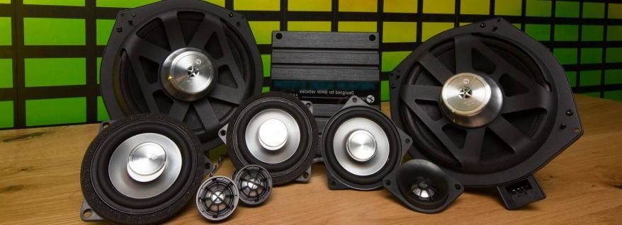

Has anyone attempted to fit the Bimmertech Alpha One speakers into the F-Type doors? They look almost identical fitment wise.
