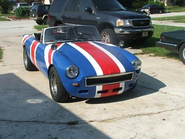

a toy i sold, you can still see the jag in the background!!
mg 003
Ahhh the good old days, i miss my mg! Cant access the pic from my phone for some.reason but its in my photo album.if you guys wanna check it out it was a total ground up restoration with mods!
logged on from computer and figured it out! it was a 75 rubber bumper, had to get rid of the bumpers they were enormous, even in jag speak! lol
