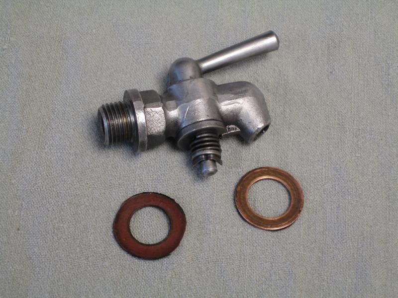

there is a block draining **** on the driver's side of the engine block, behind the exhaust manifolds and engine oil dipstick tube, you turn it open and coolant drains.
looks like this:

Just a side note that I have an '86 and I don't have a petcock to drain coolant from the engine block. I just have a hex head plug that needs to be removed. It's in the same location that Jose described. Not sure which you might have, but I didn't want you missing it while you looked for the petcock if you don't have one either.

someone might have replaced the petcock with a hex plug, all Jaguar blocks had them since the late 1950's. My '65 S type has one too. Same part for 40 years. Very handy. contact David at Everyday XJ if you need one, he has a few.
careful when loosening the thermostat housing nuts, the studs have a tendency to break, spray rust blaster for a couple days before you try to losen the nuts.

My 87 Ser III did not have the drain ****. My 88 XJS did not have the drain ****. My '95 does not have a drain ****. I've worked on several of each that did not have drain *****. The Ser III parts catalog shows plugs, not drain *****. The Ser III service manual mentions block plugs, not drain *****. The XJS manual refers to drain ***** only (and quite specifically) on "pre HE" models.
OTOH, the XK120, XK140, and Ser I E-type that I take of all have drain ***** in the block.

no absolutes with Jaguars, it's whatever they had during assembly, but mine has had it since I bought it, and my S type also has one, both in the block AND in the radiator. (also shown in the Factory Manual and Parts Manual). I asked David Boger about these XJ draincocks and he says he has them. (assumedly removed from his parts engines).

These drain ***** are pretty much useless because the passage clogs up with crud, so it usually hs to come off, so you might as well have a hex plug. This rear area of the block gets very clogged up over time.
