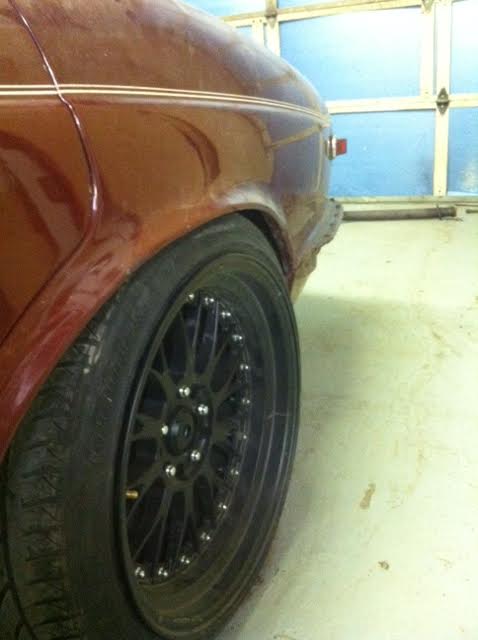

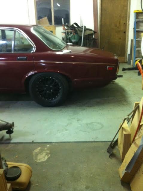

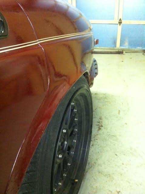

Old Jun 25, 2014 | 10:52 PM
AristoCat's Avatar
Joined: Sep 2010
Posts: 221
Likes: 27
From: Seattle, Washington
it looks different now, but these are some BBS LM reps
Doug is right about the hub bore being too large.
its possible for you to remove the rear spindles & turn them down (that's what we did) to fit more common wheels
the fronts we just made a wheel spacer

Sorry for not getting back to everyone, been laid up with kidney stones for a while now. Anyways Aristocat how low is your Jag with the black BBS wheels and what size rims 16,17,18????
18x10
It's LOW
But it has a completely custom suspension. (we are developing a beta, soon to be tested again)
