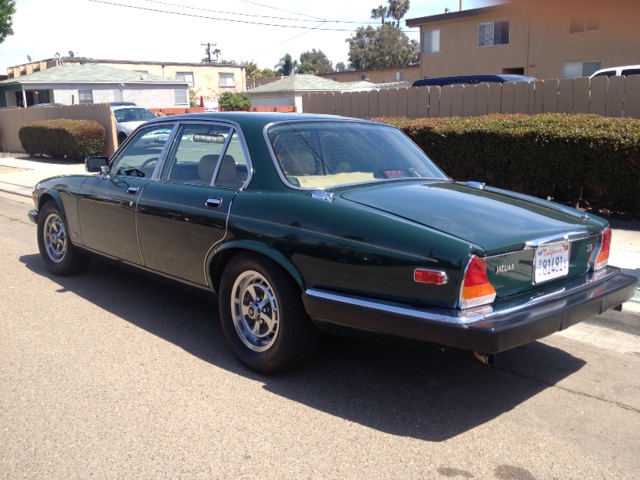

As I started this thread I thought I'd post what I've gone and done on this question. My wire wheels arrived and it was time to buy the rubber to put on them. Back and forth on the white stripe tires but the only ones I found that were even suitable were some Bridgestones and I just didn't like the thread pattern or looks. Michelin was having a sale so picked up some in a staggered size of 205/70/15's for the front and 215/70/15's for the rear. Pictures below. I happen to like the look and the feel. Gives the car a bit of a slightly lower in the nose look which make it look a bit more aggressive. Color by the way is BRG and yes, those are 7" headlights. 2 of the photos are the after shots and 1 is with the prior chrome Kents. Opinions?
Attached Thumbnails Altered and Mixed Size Tires-jag-xj6-wire-wheels-view-2.jpg   Altered and Mixed Size Tires-jag-xj6-wire-wheels-view-1.jpg   Altered and Mixed Size Tires-xj6-ser-3-green.jpg
Old Jun 25, 2013 | 02:37 PM
Socal's Avatar
Joined: Jan 2013
Posts: 112
From: San Diego
Thanks for posting pics, it really puts the whole thread together! NICE LOOK!
Old Jun 25, 2013 | 05:09 PM
Fraser Mitchell's Avatar
Posts: 9,548
Likes: 2,548
From: Crewe, England
Nice car ! First I've heard of having different widths like this on a Series 3, but you only have 10 mm difference there anyway, I don't think any harm will be caused. Why the difference anyway, was there no choice ?
Old Jun 26, 2013 | 08:39 AM
Padrino's Avatar
Joined: Mar 2013
Posts: 183
Likes: 20
From: San Diego
Just wanted a different look, no other reason. I like the front has a little rake to it now, nothing noticeable, just ever so slight. I thought the 215s filled the front wheel well too much and the 205s do look better there while the 215s look great on the rears. Of course the wires are the real key part of the look. WOW! Now just keeping them clean and tuned is all.
