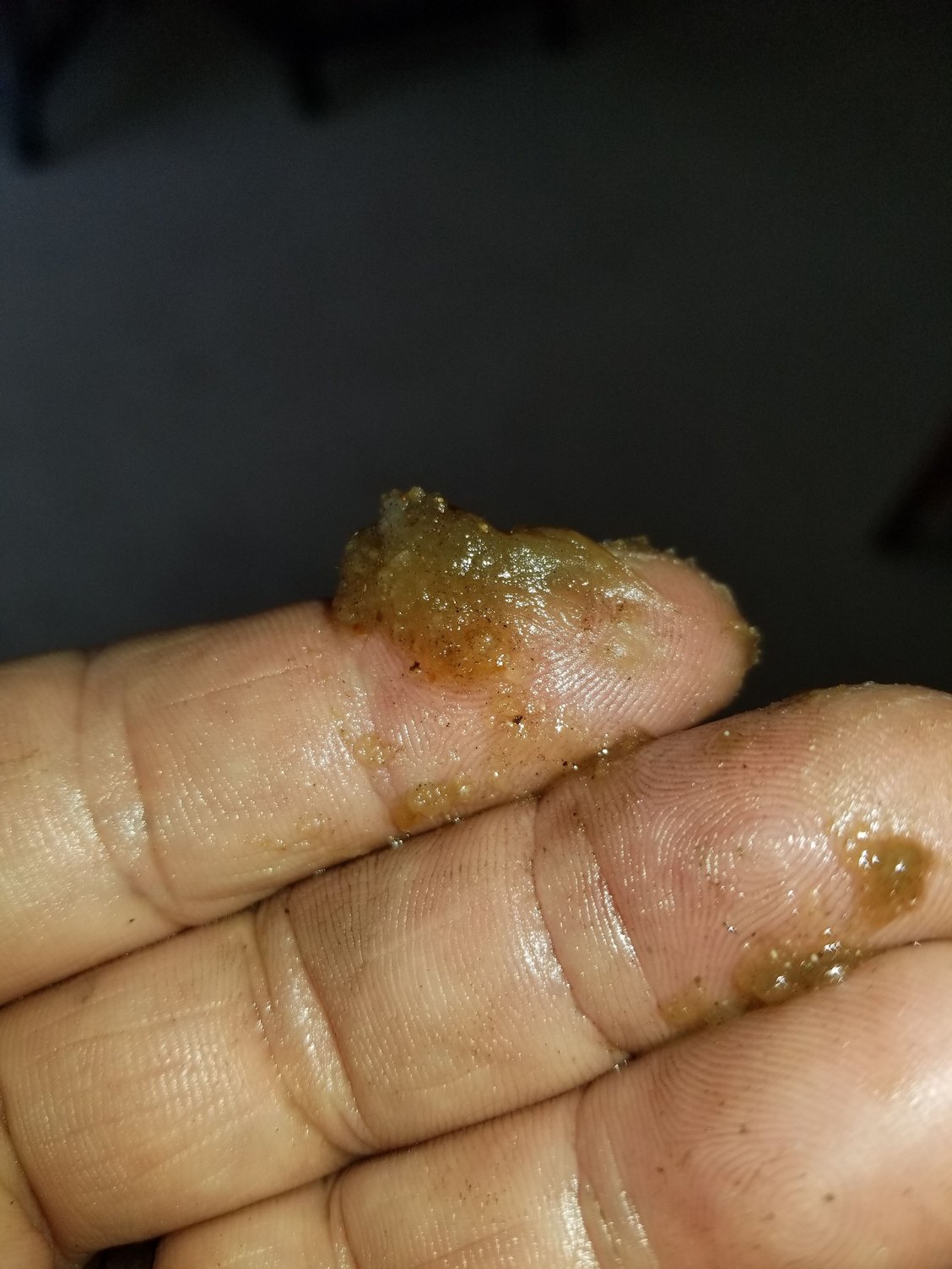

I have one in my boat, had it out and ran great for about an hour, then started running really poorly, no power, and very strong gas smell.. tore it apart again (rebuilt it a year ago but it sat) and found what my best guess is separated fuel that turned to jelly Inside.. see pic, anyhoo.. cleaned it all up, checked filter and water separator, both were clean.. anyways.. whilst taking carb apart I stripped the ledges off of one of the main jets ( the slot for the screwdriver) and now I cannot get it out for the life of me.... anyone had any luck with an easy out or something along those lines.. jet is brass and carb is aluminium, so drilling is out!!!
