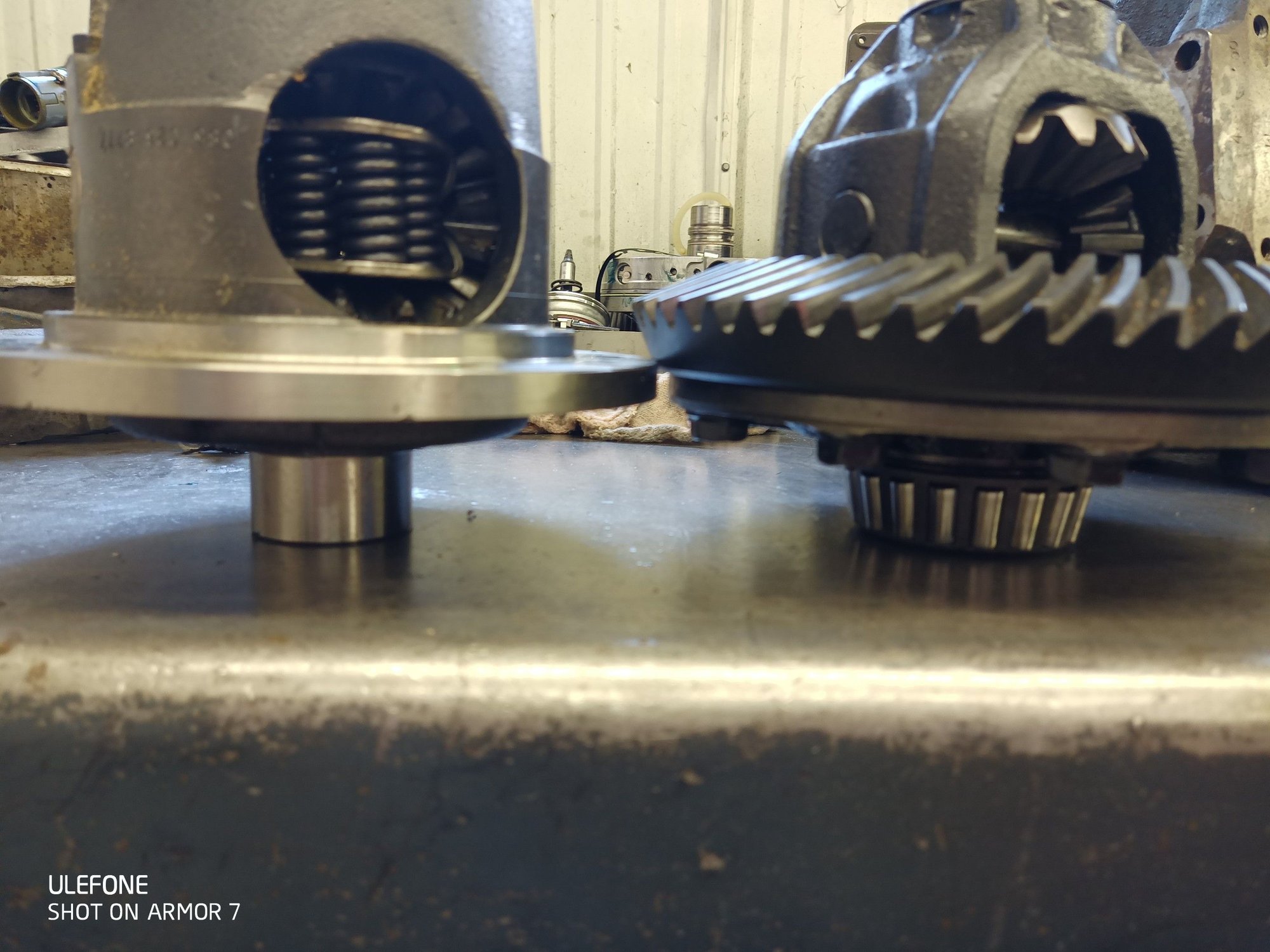

Hello! Looking for some detailed information to help change out my carrier for an Auburn unit. Currently have 4HU Salisbury 1984 unit with 3.058 gears. So far I have been able to find the basics for this conversion, but could use a little more help....
1) Bearings/races Is it easier to get a kit (Yukon YKD44-JAG or YK D44-19?) or pick up individual parts. Will need shims and I believe a crush sleeve(?)
2)Can I use my current gear set? This is where I haven't been able to find specific information. It seems the carrier deck height is a little taller (thicker?) with the new Auburn unit.
Is this typical?
Hope I'm describing this correctly. Any help would be greatly appreciated!

The part I was concerned about was the difference in where the deck ends up when the new lsd unit was next to the Jag unit
Fortunately the measurements that actually matter are from where the carrier bearings seat to where the ring gear seats
These measurements actually end up very close!!
But I may need to use a spacer for the axle hubs?
Any information how to do the spacers would be greatly appreciated
