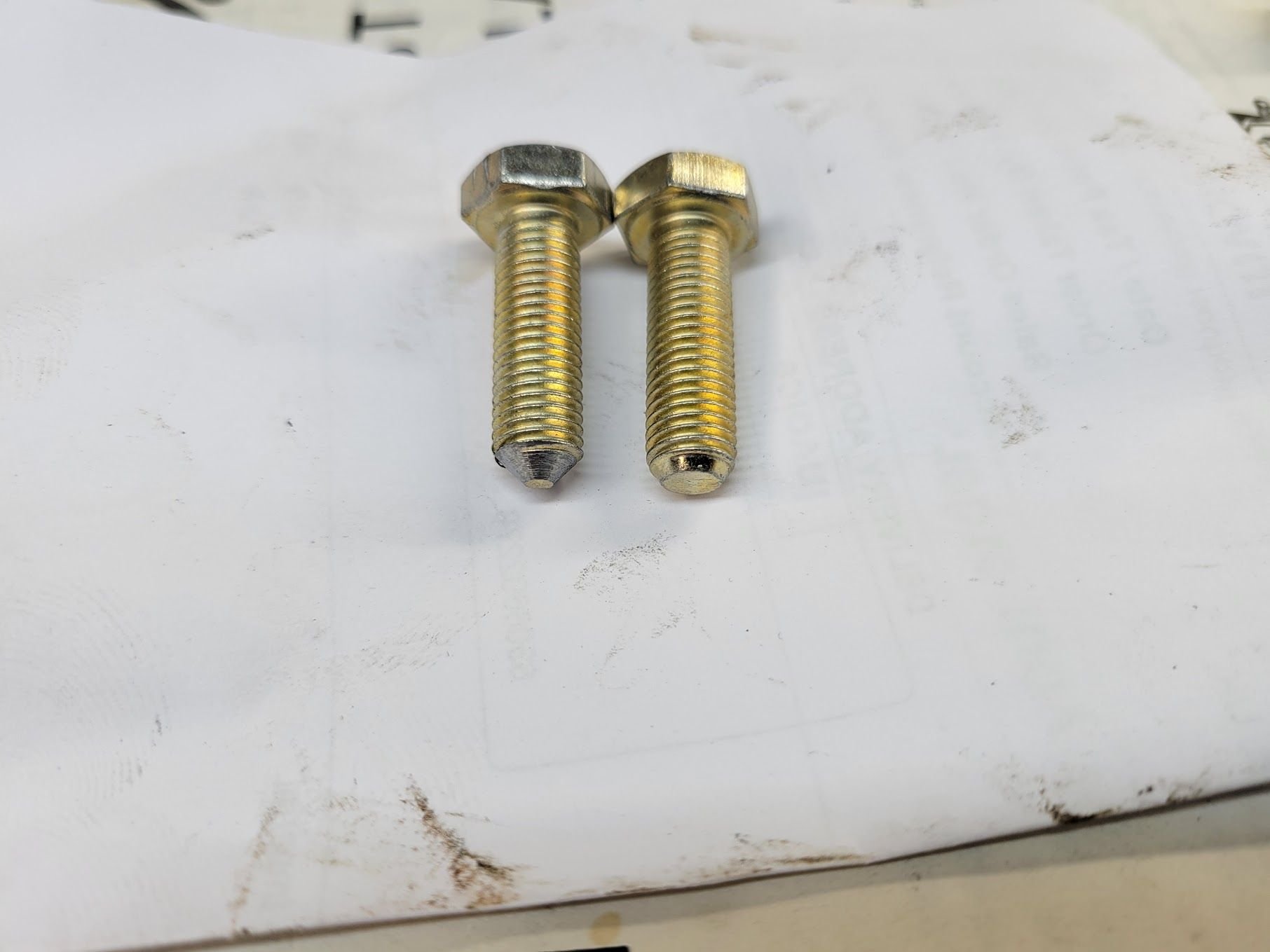

I found that putting the hood back on by yourself goes much smoother if you have bolts that have a point on them. The point helps center the mount plate and prevents mis-threading. A few minutes on the lather and I had a set ready to go.

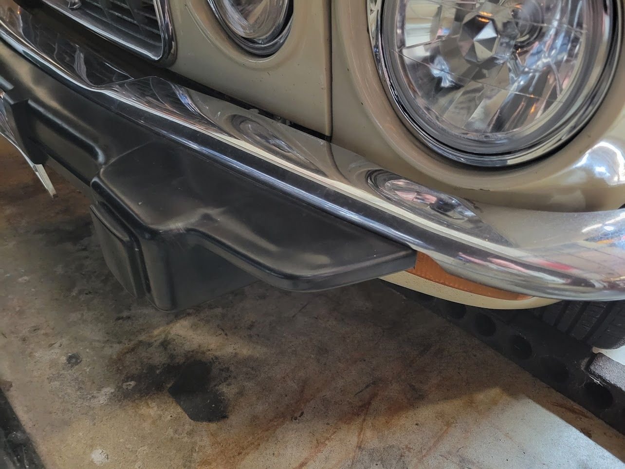

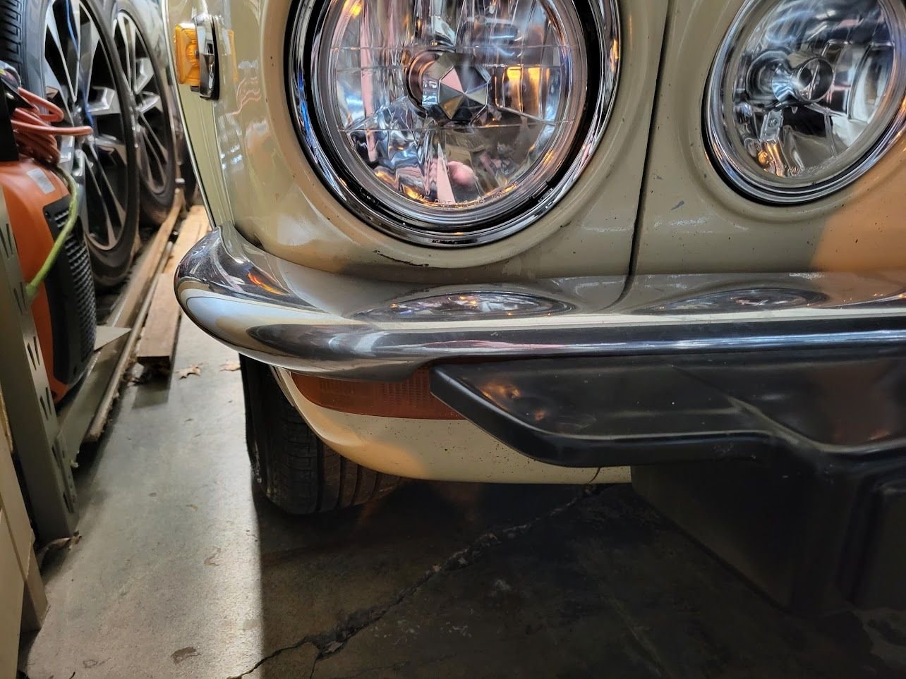

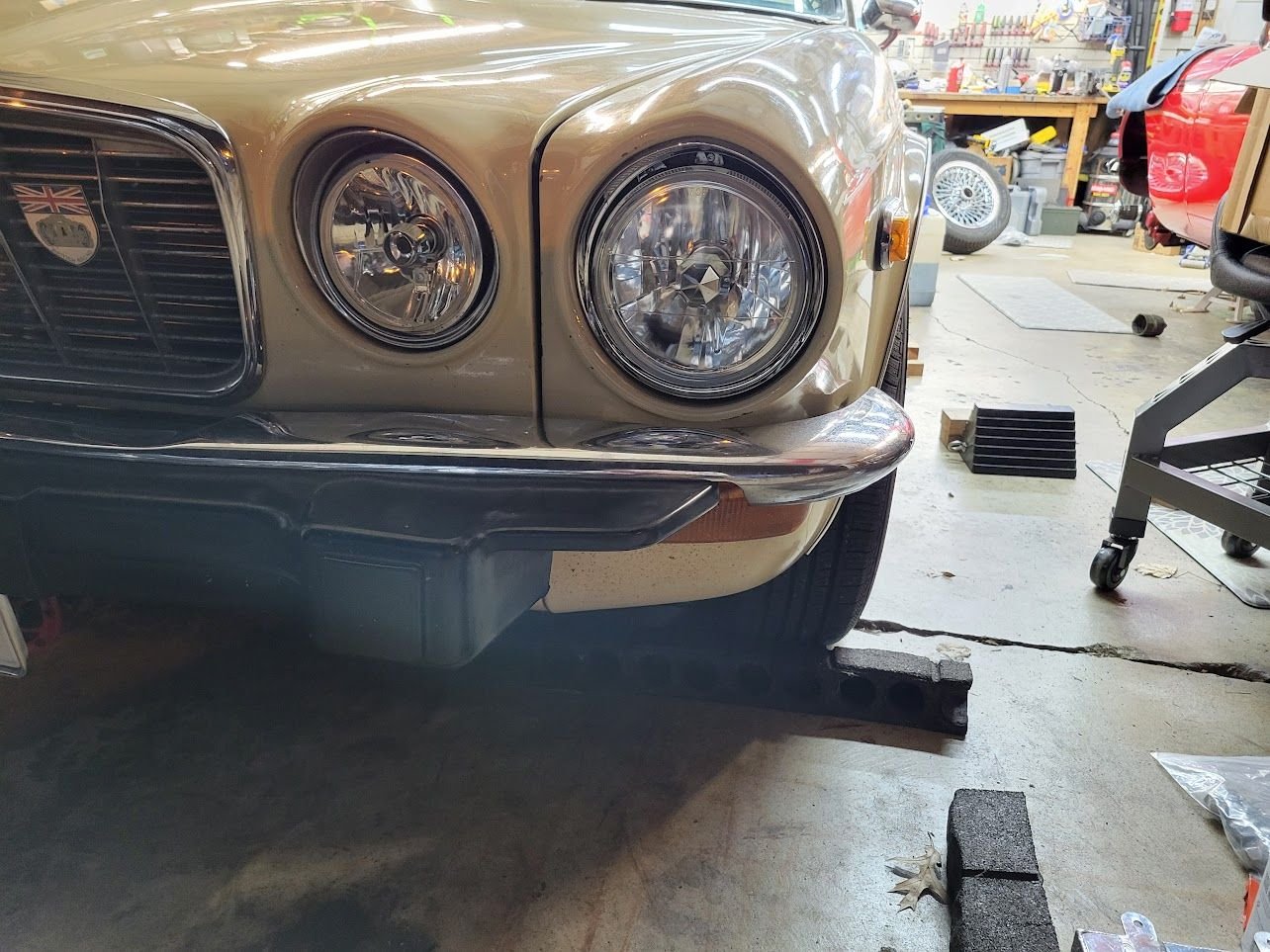

Any ideas where this bumper came from?

Torsen
That front end and the direction indicator lights location looks to me a bit like that on the Coupé:
1975 Jaguar XJ 6 4.2 Litre Coupe - a photo on Flickriver
And here is a shot of a UK mark 2 with turn signal lights quite like yours

Further to the above, it looks to me like you have a UK spec bodywork and turn signal light and a cut down rubber bumper insert fitted to it, each of which are shown in these shots:

That has to be a very rare factory version bumper. I suspect maybe the first iteration of US market compliance but obvious that the euro signal lights could not be seen properly and required further development into the ugly US log like on my car. I don't recall ever seeing that bumper before. Very interesting, and I think not modified, too well done.
Those pics from Greg ...damn those coupes are gorgeous cars! I want one of every color.

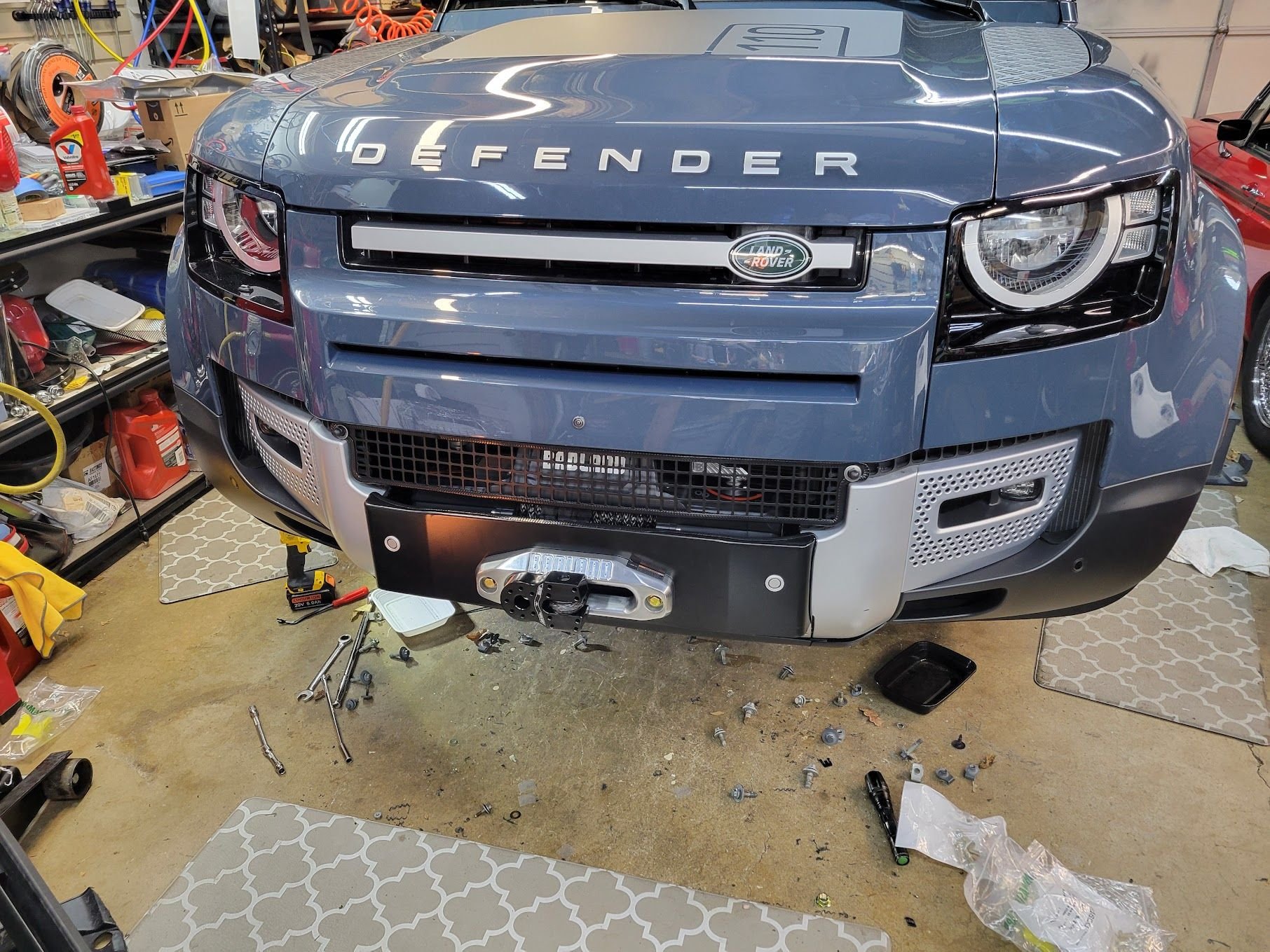

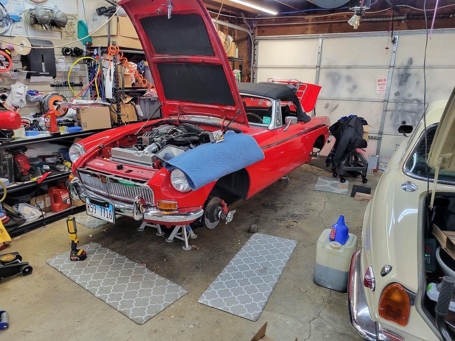

I took this week off work, and since my wife was out of town I've been having a blast spending 10 hours a day in the garage. All 3 of my British cars spent time in the "project car" slot in the garage this week.
The Land Rover (we still count those as British, right?) had front end surgery to install a winch. This project made me appreciate nuts and bolts - most of the front end was held together by plastic clips.
The MGB needed a new exhaust resonator and an oil change.

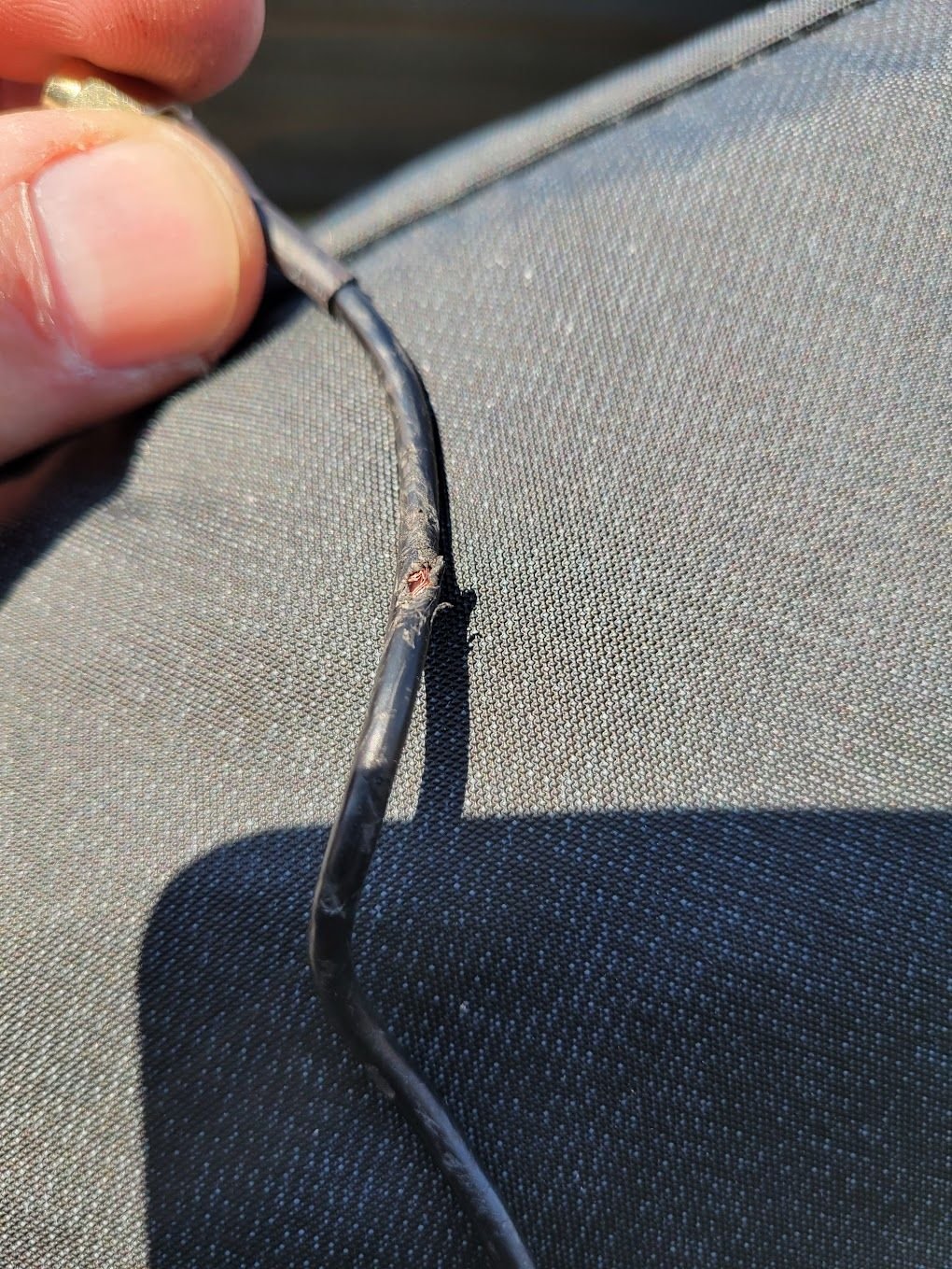

Then I shuffled the Jaguar back to her rightful spot in the garage. I was able to find the cause of the poor GPS speedometer performance. A damaged GPS antenna cable was the culprit.
I know exactly how it happened - when I went to drop the steering column last month to replace the intermediate steering shaft, the two captive nuts that hold the steering column to the body had an issue. The strap that holds the two nuts in place broke, and when some goof tried to loosen the bolt with his impact wrench - it twirled the broken end of the strap around. I knew it messed up the oil pressure light wire (easy fix), but it also knicked the GPS speedo antenna wire too.
Much to my surprise, I happened to have a spare GPS antenna on my shelf and even though it was from a different manufacturer - the plugs were the same. I put it back together and now have a working speedometer.

Ahh, found another! So maybe this is a one year (1974) bumper variation Thorsen.
Jaguar XJ6 XJ12 Front Bumper Complete 1974 1975-1979 Rare - Picture 1 of 5

Thank you for sharing. It looked too well done to be a home made job.

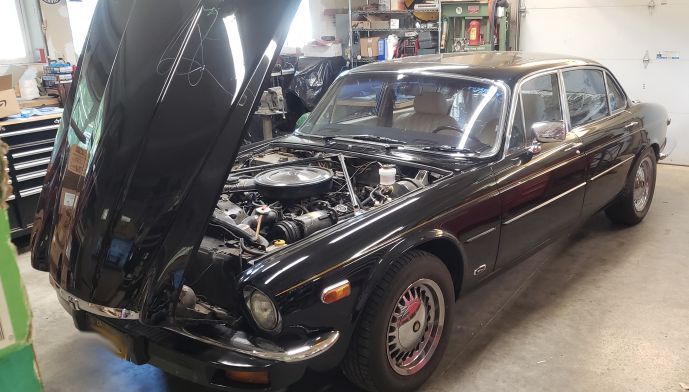

Just unloaded the car from the hauler after it made it's way from Arizona/California to Chicago. You only get a teaser picture for now but this is proof that I stayed close to my love for classic Jaguar's.
