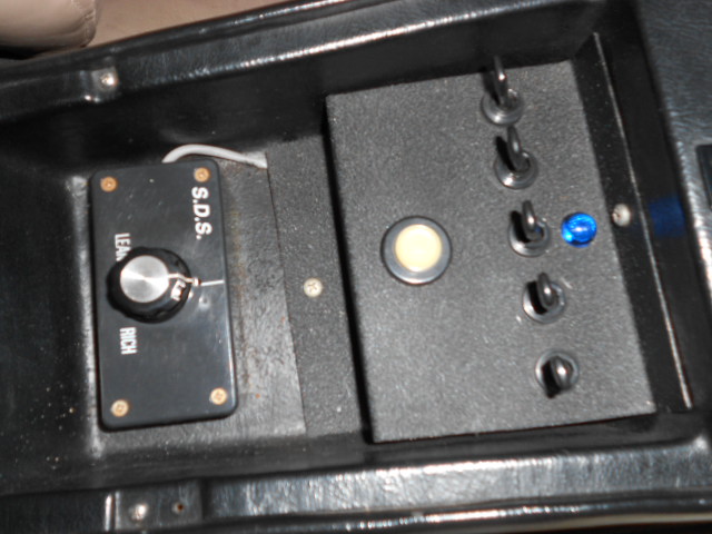

dont you wish you had an adjustable ECU like mine, slight push of a button to richen/lean fuel mixture, while you are driving, so easy!
Attached Thumbnails backfire through intake..-center-consol-j-bond-system-001.jpg
