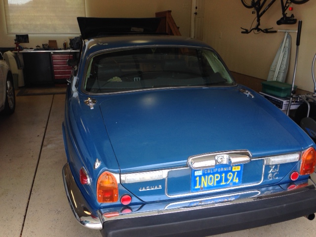

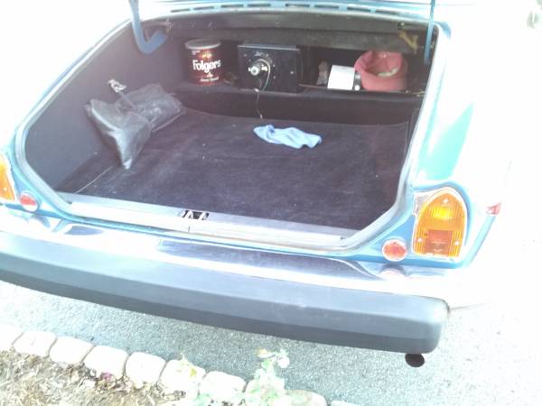

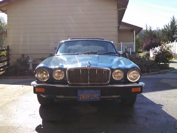

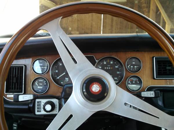

I went and checked it out again. no rust in all the area i was told to look.
now the floor panels the front seats are great the back there is some rust but i think its just surface rust and didnt go all the way through. im thinking i could clean it up and piant some of that metal rust cover stuff. owner is almost finshed with the carb im thinking next monday i will be taking ownership .
here are some pics.
here are some pics.
Wow, picts look nice. Too bad that rear seat is damaged but replacing the seat bottom is not difficult. Fuel injection was in its infancy back then so you're probable better off with carbs. The steering wheel is a nice touch. The car looks like a survivor. If you're doing a restoration you'd be at a good starting point. Just curious...What's you plans for it? Full restoration or driver?
